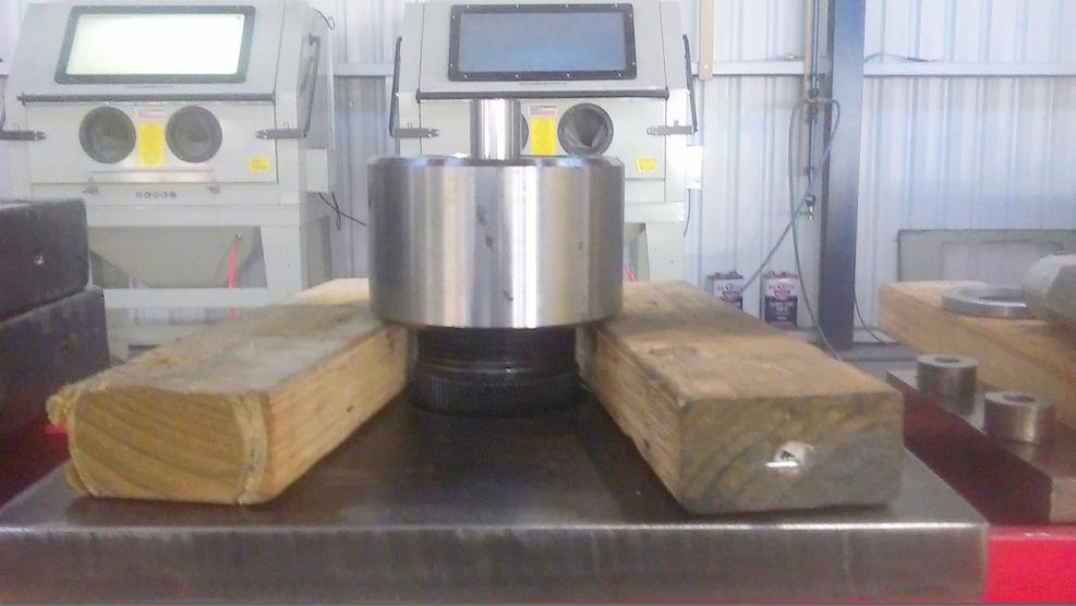

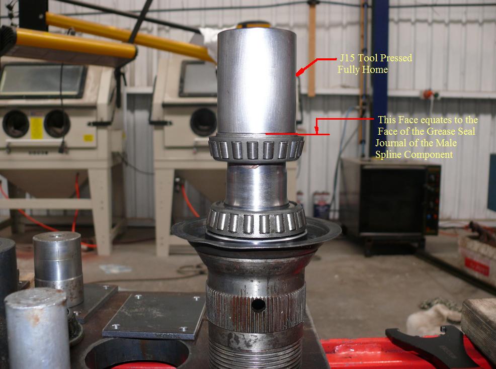

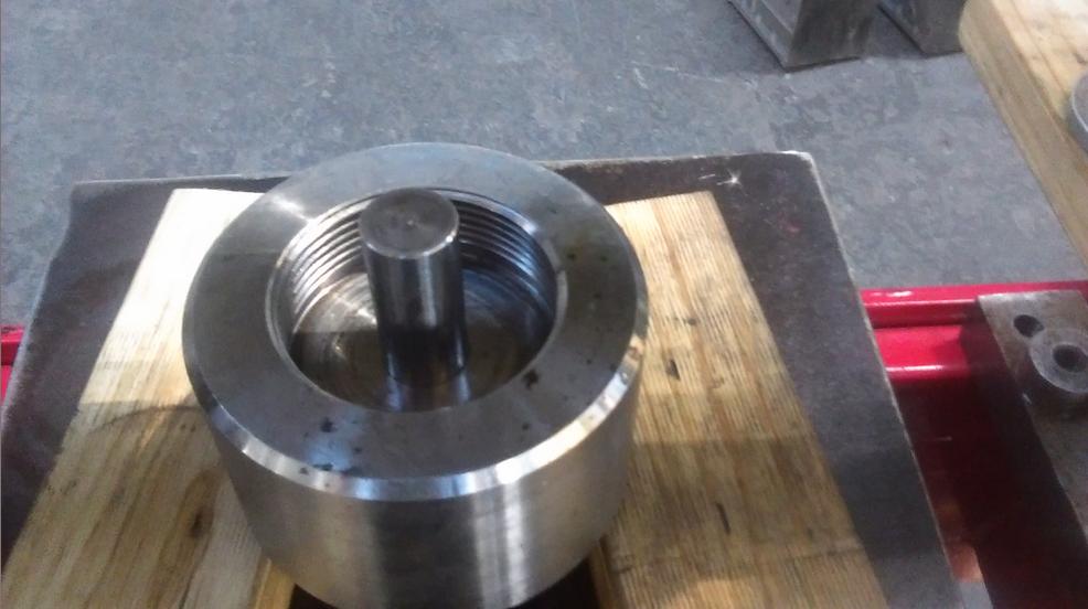

Richard Wrote:
The process for Splined Hubs is exactly the same as for Studded Hubs, the only difference being for the rear hubs which require a different Hub Extraction Tool; JD 1D for Studded Hubs and JD 7A for Splined Hubs. Following is my set up for removing the Rear Spined Hubs. The actual JD 7A tool is effectively the same, except where I have a sliding fit for the Press Mandrel in the centre hole, the actual JD 7A has a threaded hole for use with a Treaded Mandrel to do the pushing. If Loctite has been used on the Half Shaft Splines, removal of the Hub is beyond the capability of the actual JD 7A tool using the threaded mandrel and hence my development of the setup shown in the pictures below.
The picture showing the tool sitting on timber is only for display to show the Hub coming up through the plate from below.
Even with this setup, heat will be require to destroy the characteristics of the LocTite if permanent variety has been used. Ten Ton pressure is my limit pressing cold.
Where the heat needs to get is well insulated by an air gap, accordingly, its hard to get the desired area hot with a flame, it needs to be a soaking type of heat as per an oven and for that purpose we have an oven where the whole Half Shaft, Hub Carrier and Hub can be accommodated (Seen in the right background of the following picture).
All of the end float specifications for Front and Rear Wheel Bearings for the S3 cars have been tightened up; accordingly, use the values specified in the S3 Manual.
