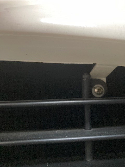

#26 Re: Radiator Grille
Post by Paul Buckley » Tue Jun 28, 2022 1:58 pm
Hi Bill
The top of the grill is secured by two clips which uses self tappers to fasten to two 'tangs' which are welded to the inside of the air intake, as per picture.
Are you saying that there should be two further 'tangs' welded to the inside of the air intake for use by the BD39095 clips?
Best regards
angelw
Posts: 559
#27 Re: Radiator Grille
Post by angelw » Tue Jun 28, 2022 2:47 pm
Hello Paul,
No. the tang of the BD39095 clips are secured by one self tapping screw each, directly to the lip of the air intake. The other end of the clip locates in the channel of the chrome moulding.

Paul Buckley
Posts: 84
Location: Northwich, Cheshire
#29 Re: Radiator Grille
Post by Paul Buckley » Wed Jun 29, 2022 3:01 pm
Hi Bill
Got it!
I was confused as to how the clips could possibly be used with the chrome finisher snug against the bodywork.
They can't, in that scenario, but I had not realised that the chrome finisher actually protrudes slightly below the curved body line in order to allow the clips to fit inside the chrome finisher!
You commented previously that the chrome finisher was a dreadful fit .... now I understand why!
I have inspected my bonnet for any tell tale holes, both outside and inside the bonnet nose flange.
There are none, neither is there any evidence of plastic filler being used, anywhere.
So I guess that the ding on the nose has been repaired properly, but why I can't find the two clip holes?
A mystery. Perhaps they were never fitted on my car.
However, I now need to drill the two holes for the pop rivets, but I think I will wait until I get the
BD39095 clips.
Thank you Bill, your time and help is very appreciated, not to mention your patience!
