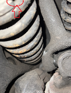

Take a look to see what the undamaged side looks like and figure out why the bad side is asymmetric to the good side.
Also, assuming the second photo is looking upwards, it looks like you may have a collet missing - it may be the angle, but I don't understand what the gap circled is. The shock is pretty dangerous in this state as it holds a huge amount of stored energy - enough to take your face off.
See arrowed photo .

As always thanks for your insight. Going to remove and replace all shocks today. I will check the circled part. I think it is the end of the spring. My assumption and hope is the top bushing has failed allowing the shock to move. Everything else appears to have no slack movement, u-joints, wishbone and radius arm. I will check again after removing shocks. I took lots of pictures and will take more to see if anything has changed. Tires are at 32 pounds from last road trip. Height appears even on both sides. I will measure it today.

Jacked the car back up with jack stands under the wishbones. Lifted the body to release the weight on the shocks and the left front shock is broken at the mount.
