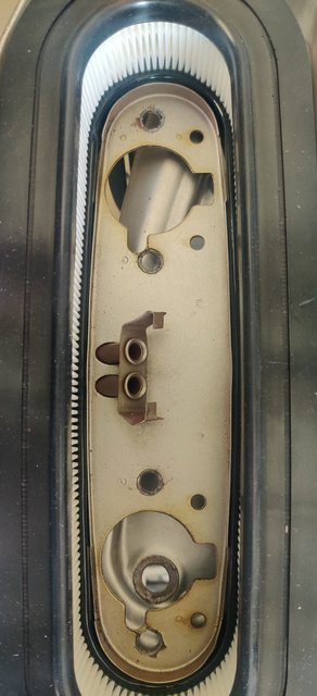

So: opened up air intakes to replace the filters. Temperature sensors have been deleted on both intakes so no connection to the circular body that in turn controls the flap. I assume this was as part of an overall removal of emissions control items. But it does mean that where the temp sensor was there remain tgec2 inlet/outlet tubes for the vacuum hoses (see photos). Should these not be capped iot prevent unfiltered air being sucked in?

To cap it not to cap, anyone? "But it does mean that where the temp sensor was there remain the 2 inlet/outlet tubes for the vacuum hoses (see photos). Should these not be capped iot prevent unfiltered air being sucked in?".

As you say, they let in unfiltered air, so if you are not going to reinstate the air temperature control system they need blanking.
