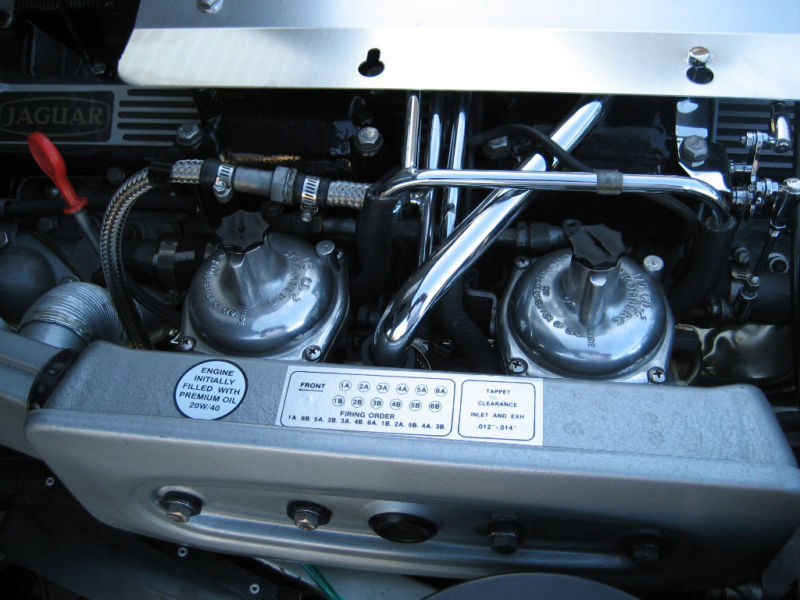

The most prominent decals are probably those on the air cleaners:
The circular one ("Engine Initially filled......") goes on top of LHS air cleaner near the front
The rectangular one (firing order and tappet clearance) is placed centrally on the top of the LHS air cleaner
The smaller rectangular one ("For lubrication and information.....") is placed centrally on the top of the RHS air cleaner.

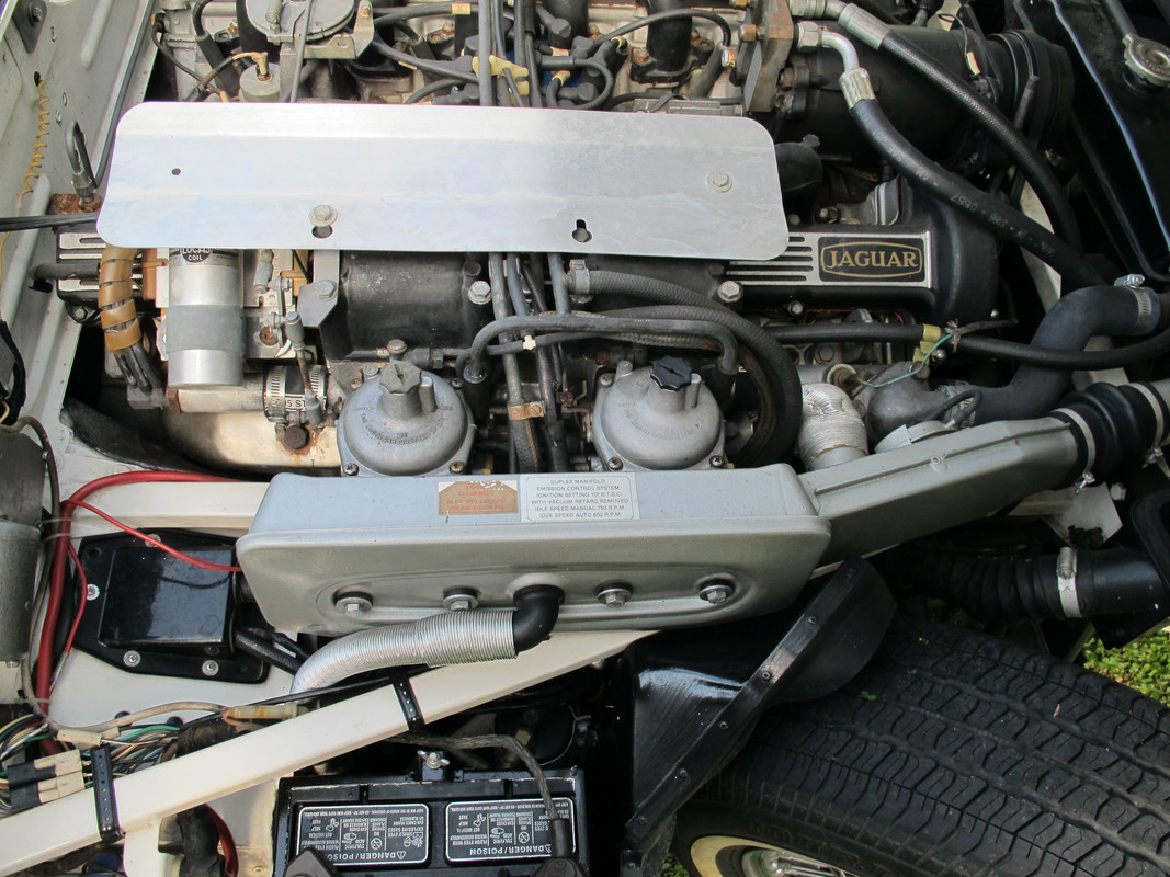

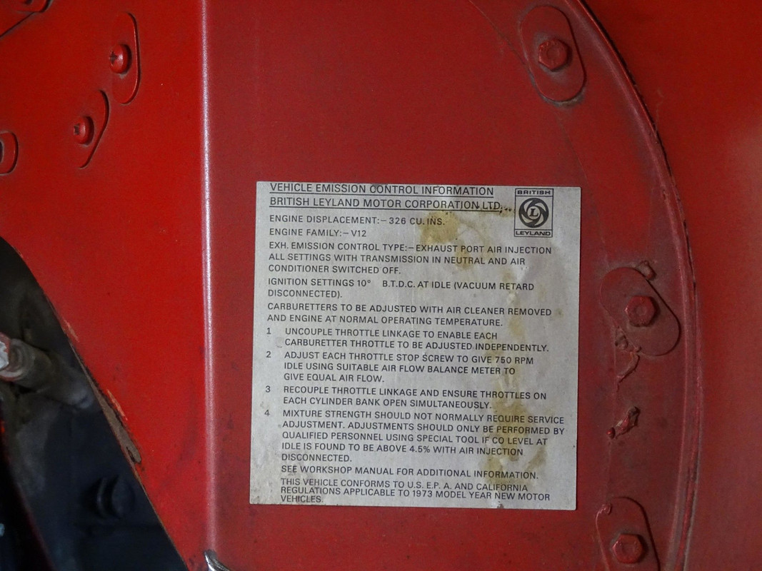

The only label stuck to the underside of the bonnet by the factory was the US Emissions compliance and tuning sticker indicated in the first picture which is of a 74MY car. The 73MY version is shown in the second image.
A small rectangular recommended lubricants label was stuck to the top of the RH air filter housing and a small round one identifying the initial fill being 20W/40 to the top of the LH housing together with another showing the tappet clearances and firing order. (enlarge the first image to see these)

Thanks, Bob! Yes, this is very helpful. Maybe the owner is thinking of something that was added when the car was imported into the U.S.? (He bought it right off the boat in Baltimore.) But glad to hear that no such sticker was issued by the factory. The photos are a perfect reference — thank you so much for sharing those.

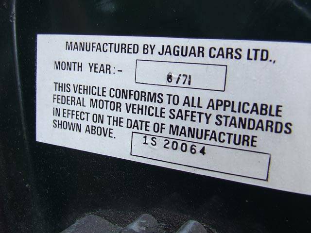

Got have some good replies already.

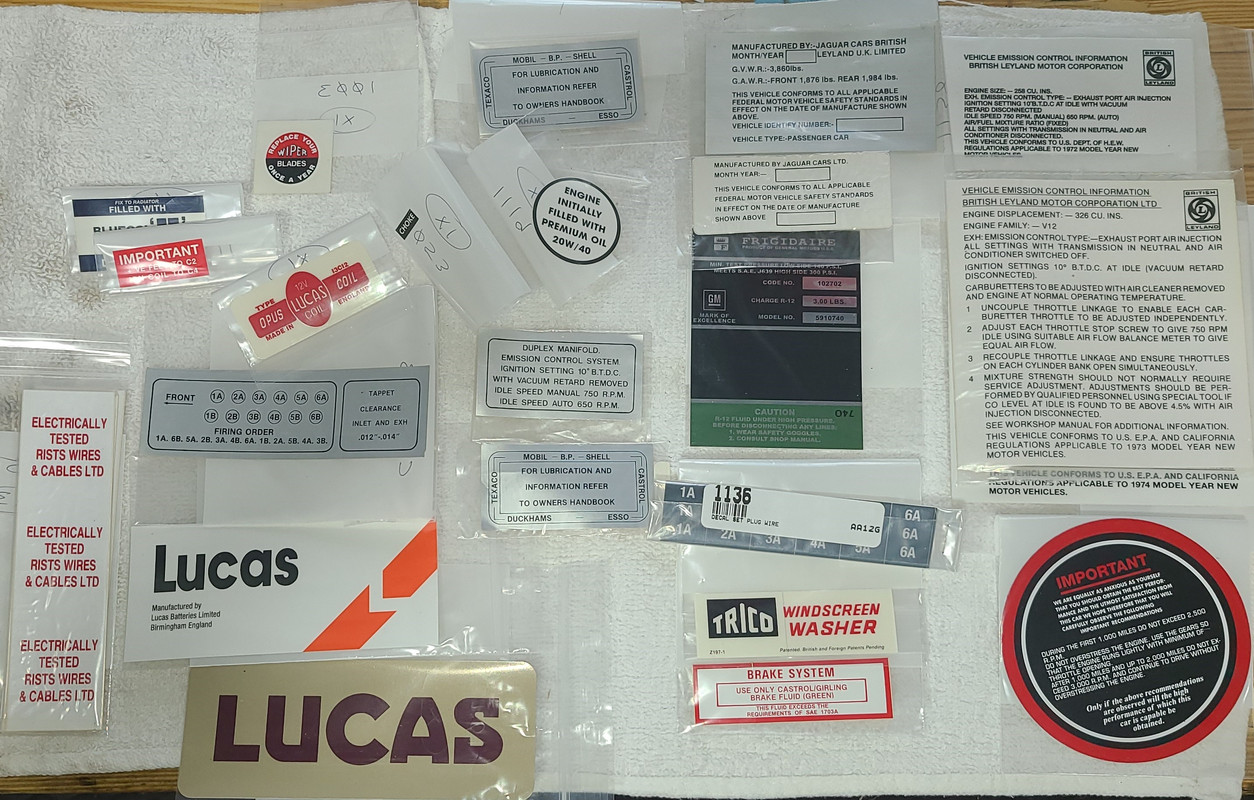

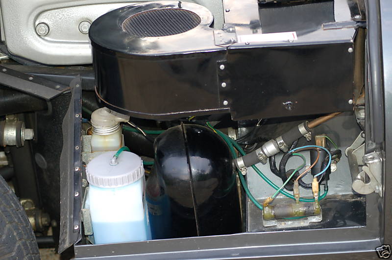

I am restoring my SIII OTS and have collected some photos off the web
First Photo is of the decals I picked up to be applied at the every end of the process
Other photos were collected to help locate their positioning.
Hope this helps . . .

#12 Re: S3 Decals and positions - UK spec 2+2
Thanks, Craig! Photos that show the positioning really are helpful. There seem to be quite a few places online where you can get the stickers, but not so many that show you where to put them. And you just know some judge at the car show is going to be in a huff if a sticker is in the wrong place!

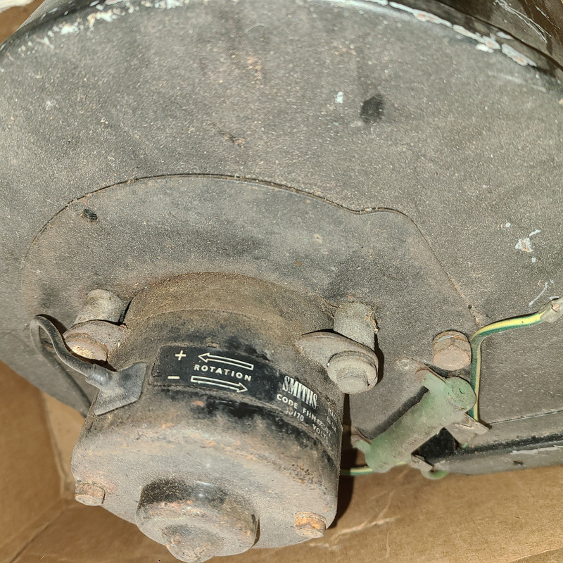

I was looking for something else and stumbled on another decal.
This one is rarely seen cuz it is on the heater fan motor which is attached to the bottom of the heater matrix -- see photo. If you look at my first photo (with the array of decals I have collected), this one is not in the mix.
It is too obscure. Now -- if your target is a Concours winner, you best get one and apply it
Further - the 5-side, reddish decal atop the righthand air filter does not belong -- I think it is a 6-cylinder decal.
Craig
