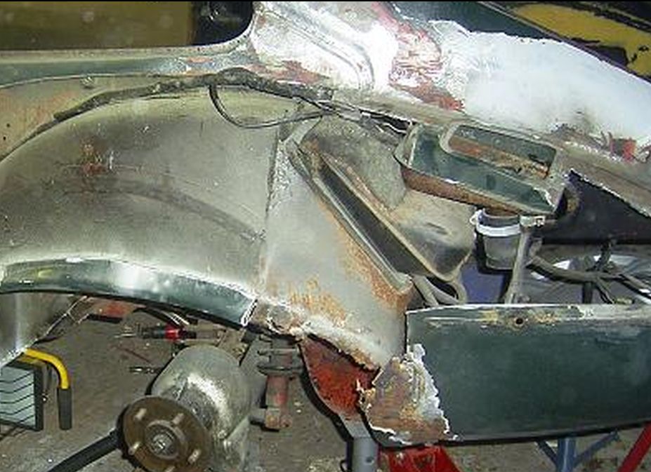

You should be able to see the expansion tank tucked away in front of the filler pipe:
The charcoal canister is in the engine bay, on the footwell bulkhead behind the battery:

Thanks both for answers - I know what I'll be doing today :)
Colin - you're batting 100% here sir. Thank you very much!
