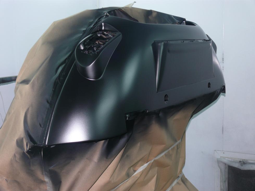

This Chin Scoop is an often damaged and incorrectly repaired component, see the following picture
At the two corners where the horizontal surface transitions into vertical, there should be radii of circa 50mm, as shown in the following picture and quite easy to fit the trim supplied by SNGB.
If you're having difficulties getting it to fit, I suspect that your chin scoop has been damaged and repaired with radii that are too small, or in many cases, no radii at all.

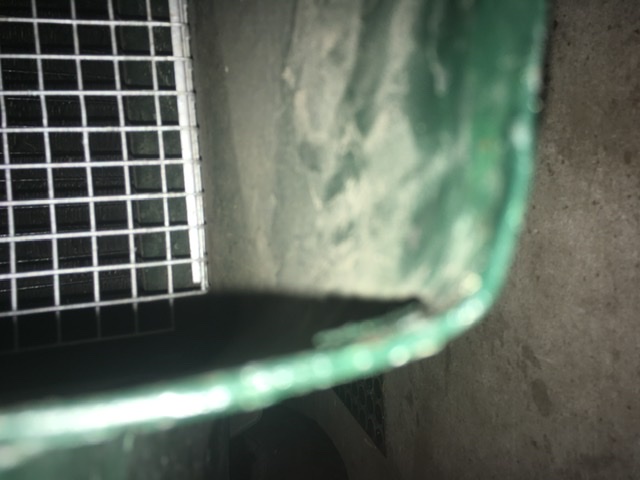

Here is a photo of the corner of my air scoop, with the radius I’m dealing with.
I might try the hot water method and see how it goes.

In the picture you Posted, the leading edge of the Chin Scoop looks wrong. It should be a circa 10mm wide strip of metal folded over on to the remainder of the scoop to form an edge that is two thickness of the sheetmetal. Probably not, but it looks a lot like wired edge or rolled edge where the radiused corners are.

Hi Bill,
You may be right about air scoop but I haven’t checked it again yet.
It’s probably been damaged and repaired at some point it the past.

Yes, its the same material, but the ease or otherwise of being able to fit it comes back to the condition of the leading edge of the Chin Scoop. If the corner radii are too small the trim tends to pucker and look rubbish, and if the leading edge is more than just two thicknesses of sheet metal, ie, if someone has wired the edge, the trim will be difficult to fit and again, will look rubbish.

Damage to the chin scoop (and hence modified repairs) often results from the front suspension being too low i.e. that damage is a symptom, not a problem. For starters, a correct chin scoop will touch the ground by merely opening the bonnet if the front suspension is too low, or perhaps, if a too long bonnet strut is being used.
My 2+2 looked very similar to the pic above, but now has the correct chin scoop shape.
