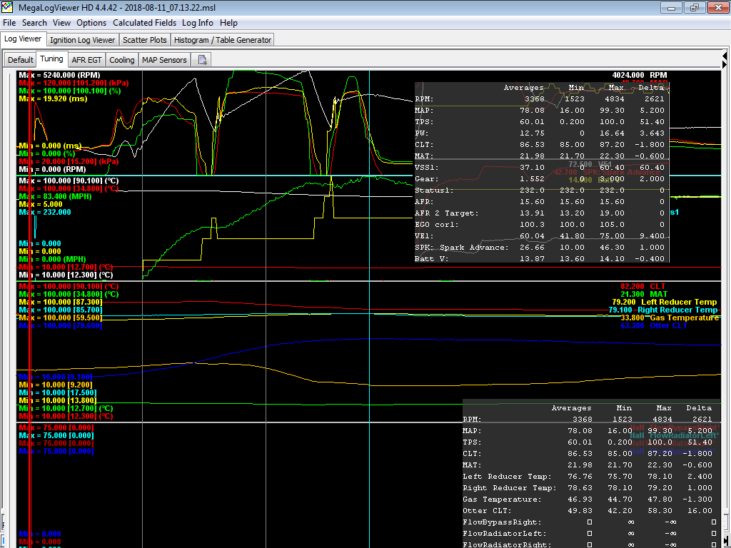

Worried about thermal shock?
In the example quoted, coolant temperature drops 12'c in 45 seconds and radiator temperature goes up 45'c in the same time. Do you really think that's a problem?
Now consider what happens every time you start your car because you already do something sort of similar every day.
Consider that if you start from cold, the thermostats start closed.... water circulates in the bypass until it's 82'c and when the thermostats open, your engine coolant is hit by virgin cold water, not lukewarm cooled down water. Granted, the effect isn't as great because water bleeds through so the changeover isn't as instantaneous, but if this worries you, then just run the procedure with only half of time delay, so the fan runs half as long before you run the engine.
That's pittance though compared to combustion temperature changes. When you gun the works, the exhaust gas temperature goes up to ~650'c in the time you go from 0-60. Coolant wise, a massive volume of water is pumped into the cylinder heads if you spin it up to the red line and the radiator temperature can go up 20'c in ten seconds. That's a tad more thermal shock than pumping water through at idle rpms and only having a combustion EGT of a constant ~130'c.
Graphs:=
Here I appear to have gone 0-60 in 7.7seconds and that's including a leisurely 1.3 second gear change from 1st to 2nd. This is the data between the two vertical grey lines where I drop the clutch at 1500rpm and rev it to 4800 (and then beyond). Ignore the bit about the car continuing to accelerate past 60 as I'm obviously not on a public road.(Middle graph shows speed in green.) The lower graph shows the coolant at the bottom of the radiator (dark blue) has moved up 16'c in 7 seconds. I'd suggest this is more thermal shock than cooling for heatsoak.
0-60 shock2.png (84.06 KiB) Viewed 8916 times
Interestingly, aside from the agricultural 1.3second gear change, I appear to have been pretty gentle off of the line in first gear - the engine is only starting to breathe at ~3000rpm. This car could accelerate much faster if it were simply held at or above 3000rpm for longer - but I wimp out at 4800rpm and spend 40% of the time at low revs below 3k.
