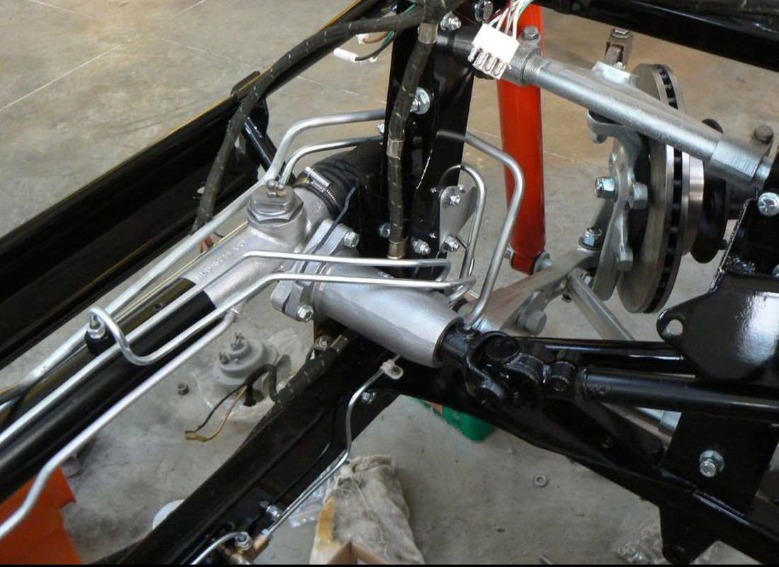

#2 Re: Power Steering
Post by Bob. » Fri Jan 06, 2023 4:20 pm
I am sure someone will have some good images but here are a couple I have come across in the past. Beware the misleading reflections on the glossy black upright.
Bob

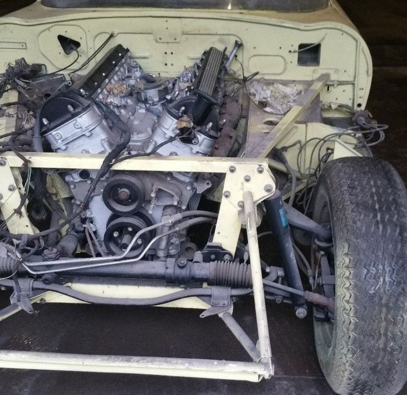

#3 Re: Power Steering
Post by lowact » Sat Jan 07, 2023 6:15 am
If you're allowed to improve it, I did it like this:
Even better if I'd had a RHD pinion, all the pipes could then all be above (the pinion). Uses the std LHD hoses.

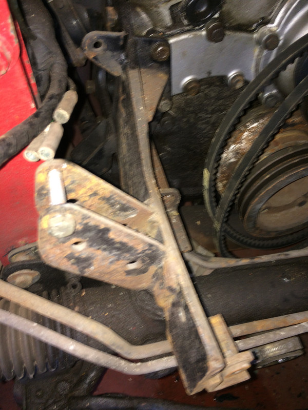

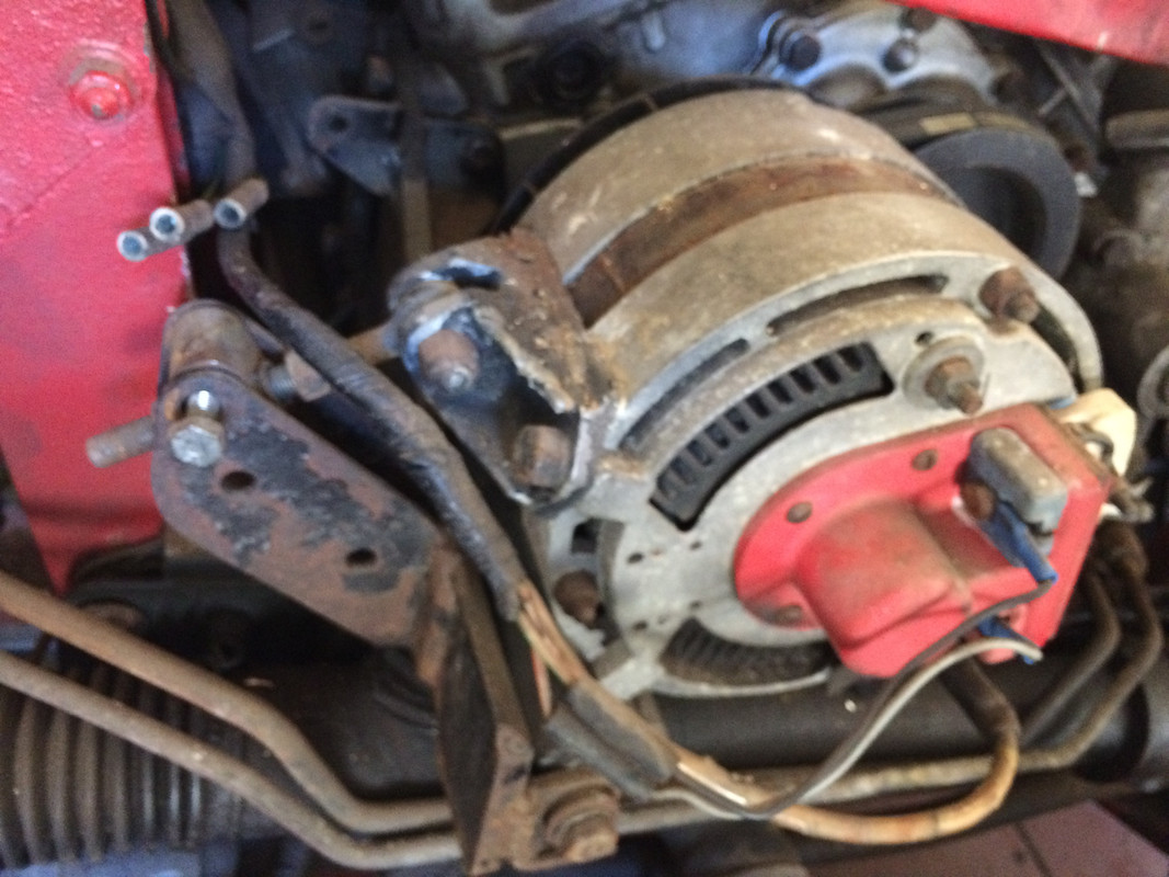

#4 Re: Power Steering
Post by Apprentice1975 » Mon Apr 10, 2023 6:08 am
Hi Pete,
do these pics help you?
I took them in '17 during the dismantling process..
Or maybe you've solved the problem now..
I've just seen your post..
My S3 is manual, RHD.
Colin
Colin
my project - XKE Series 3 2+2 manual coupe
