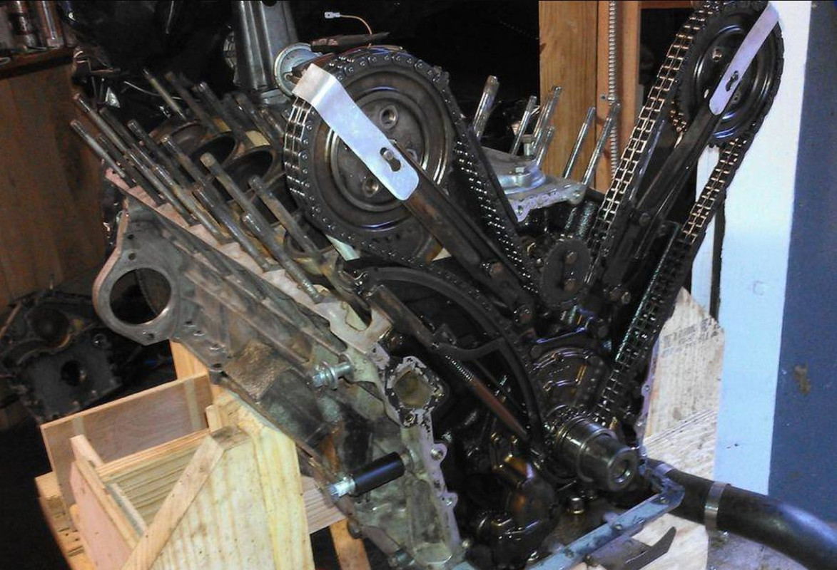

#4 Re: How does the JD40 cam sprocket tool work?
Although these are homemade JD40s, this is how they are used as per the ROM. They lock the sprocket to the parking bracket.
