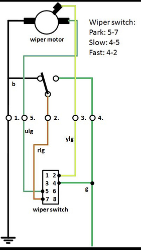

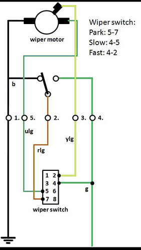

The switch on the dash controls which way power will be applied to the wiper motor.
The wiper motor runs fast when green connects to yellow. The wiper runs slowly when green connects to blue/green. The wiper parks when blue/green connects to red/green.
There is a microswitch on the wiper body which interfaces between the external loom wiring and the wiper motor internals.

I recently fitted the windscreen wiper timer from Retronics.
I needed a diagram of the connections and got this from SNGB but the wire colours were incorrect - I reckon. This is what worked for me.
E-type S2 wiper switch wiring.pdf
(229.55 KiB) Downloaded 675 times
Also I show the wiper motor wire positions.

You might find this more useful. The bit at the top is the internals of the wiper motor. The bit in the middle is the plug/switch on the wiper motor body. The bit at the bottom is the switch in the cabin.
