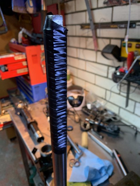

It’s not actually that difficult to rebuild yourself. I have done it twice to the same rack and yes, I did rebuild it myself a second time because it began leaking after around 8 years of fairly light use. However, I learned the first time that the main issue was damaging the inner seals when re-installing the piston/rack. The problem is that the teeth can damage the seal and the trick to prevent this is to tightly wrap the teeth section of the rack with a couple of layers of insulation tape to smooth things out and use plenty of steering fluid to lubricate it during insertion. I say a couple of layers, but if that proves too tight ( depending on the thickness of the tape), try one layer, ensuring an overlap of each successive winding of the tape:
