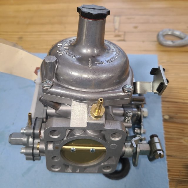

This photo shows my carb - rear left with the take off. Not as clear as I would like:
This is from the Jag-Lovers sire and shows the location better. Mine matches this image (allowing for the fact the carb is from a different location):
There was no misfiring, rather the car suffered from Backfiring, indicating unburnt fuel in the exhaust – a rich mixture. This was borne out by the sooty plugs and indication of rich mixture with the Colortune and also the fact that weakening the mixture meant the car ran much better afterward, with no backfiring. However, Idle was liable to dip and the engine sometimes shut down on overrun.. There also seems to be less power at higher revs than I expect. However, I intend to cancel the mechanic and experiment a little more. I have no idea how to fit a wideband lambda system and I think it probably beyond what I am prepared to attempt, but I can keep on with the Colortune and also experiment with the timing.

Hi and once again thank you all for some great input. I have a long weekend coming up so will try to find time to do the following:
Confirm timing – Static and dynamic
Inspect the distributor weights mechanism – believed to be free, but no harm in checking.
Check the lift of each carb piston, believed good, but as above. (Thank you madjack4)
Check fuel filter, actually changed quite recently, but as above.
Set timing to 12 degrees BTDC, check for advance to around 36 degrees BTDC at 3000rpm, then road test.
Additionally, I will be using new Champion N9YC plugs and fresh 98 octane petrol – the current tankful still contains some oldish fuel, mixed with new fuel from the weekend.
If anyone has further ideas, I’m open to hearing them.
Colin,
Thank you for an amazing offer, I have had real difficulty finding anyone in Australia, let alone Melbourne who I can compare notes with, let alone borrow parts for fault diagnosis. Whereabouts are you, or would you prefer me to PM you? Please feel free to PM me any contact/location details if you don’t want to post them here. Also thank you for reading my posts accurately, I see that I may have come across as a little foolish, or at least naïve. Hopefully I am not the former but happy to accept the latter!
I entered the recent round of tuning to get the car running for a 200km round trip on Sunday. The car performed quite well, but I think could be better. Time prevented full checks including timing etc. – if the car had not run reasonably well on the test run late on Saturday, I wouldn’t have gone. The improvement, with backfiring in particular no longer present, was dramatic and I felt it worthy of going. I wanted a longish run prior to getting more serious with diagnosis. My statement regarding timing being “stock” was my best recollection of the last time I tuned the car, but I’m pretty certain it was a foolish statement and that the ignition at idle was somewhat advanced, it certainly isn’t 4 degrees after TDC. I would have known that was a bad starting point but of course should have established the actual setting. In answer to another point, yes, with the engine at TDC, Firing stroke, the rotor points at the left headlight.
The experience has led me to check the history of the car, confirming just what is fitted. Without going into too much depth, here are some findings, from checking my records and photos.
The car was dismantled, in terrible condition when bought, but original and unmodified. It is an early car – the 97th RHD 2+2 FHC, UK spec with automatic gearbox.
I rebuilt the car completely, converted to 5-speed manual, during the process I migrated from UK to Melbourne. The first time I started the engine was in Australia.
The engine was sent for rebuild prior to leaving, as I had none special tools and time was pressing due to the move Down Under. I needed the car basically complete, for import purposes. The guy who rebuilt the engine, Brian Ball has a great reputation although he operates largely on word-of-mouth recommendation, so is not as well-known as some. Due to issues with the terrible condition of the original block, it was rebuilt using an XJS non HE block and heads, serial 8S11***SA, with as many usable parts transferred from the original engine as possible.
The distributor body was damaged beyond repair when removed (not by me) from the engine. A second hand replacement was obtained and I believe it is from a Pre HE XJS. Photos of that unit show it fitted with a Vacuum Advance unit on arrival (vacuum intake points away from the distributor body). From memory, that vac unit had a punctured diaphragm. It has 18 degree weights fitted.
In one of my early demonstrations of naivety, I simply replaced the advance unit with a retard unit, as this was original to the car. I was aware of the supposed limitations of a retard system, but not confident enough to try the conversion at that time. I bought a ReOpus Unit from Dave Curry of ReOpus and followed his instructions to ensure the unit he supplied worked with the setup I had, he was aware of the distributor, amplifier and car model and the discrepancies between them. Biggest issue was the supply to the tachometer, but with his assistance, this was overcome.
Carbs were totally rebuilt, including new correct spec needles (I think they are different on manual vs Auto, from memory, possibly not) New jets etc. were included in the kit. I had two sets of carbs, so was able to replace some parts with better as required.
Plugs are NGK BP5ES, not particularly old. Rotor Arm is a New Old Stock Lucas item, cap is from SNG, again not particularly old. Pump is original with a rebuild kit and operates well. The fuel return circuit operates with the proper “fizzing” sound evident from the Pressure relief NRV.
The Vacuum advance unit is a 54405202 unit and has the ability to adjust the level of response to the vacuum. It was recommended and supplied by British Vacuum Unit, who responded to my enquiry, advised me on the best unit (of the many they supply) and advised on the location of the port to drill for the ported vacuum take-off – this matches the location of several other Stomberg ported vacuum take-off points, notably the triumph TR6. The hole is .54” before the exit into the inlet manifold, placing it just before and above the throttle disc of the left rear carb (relative to inlet airflow). See pictures in earlier post.
I can’t think of any further relevant points but Colin, I would love to come up and look at your projects, share notes and possibly take you up on the offer of a loan, hopefully, you don’t regret the offer – I will understand if you do.
Thanks to you all once again.

Colin, thanks again for the input and offers. I will be very interested in your mods, the GasCat looks seriously cool, how do you feel about making double quantity of everything…!? Just joking of course, but I wish I had the knowledge/skill/confidence to undertake such a project.
Whilst I am fairly positive your knowledge is vastly superior to mine, there is one question that I have regarding fitment of Pre-HE cars. Evidence I have found suggests that at least some pre-HE cars were fitted with Advance units, but it seems Australian cars were late to the party. Perhaps this is where the confusion enters the scene?
Anyway, the data comes from the Jag-Lovers Site, where Mike Morrin did some research as long ago as 1998. The link is here:
https://www.jag-lovers.org/lists/archiv ... 00081.html
In a more recent post he has recognised that unit 41677 does exist (See the link for more detail).
I had no way of adding the data to this post, except to create a table and screenshot it, but below is my best effort at that for quick reference. Note the original post and some of Mike's follow ups give more complete information. Note that 41622, 41640 and 41642 are all indicated as Advance units fitted. I therefore believe there is a possibility my distributor, which came with an advance unit fitted and is believed to be pre-HE, may actually be as original and correct. I'm still searching for more detail and will also try to find the part number on my distributor at the weekend.
On another note, the tapping for retard, under the carb, has been blanked off. I’ll test to see if the unit does in fact advance timing with suction as soon as I am able.

So a bit of follow up. I did some research and discovered there are definitely other Pre HE V12 cars that were originally fitted with advance units. The XJ12 Series 2 cars were fitted with distributor 41742A, which is the one that I bought for my car way back in around 2006 or 2007, before I knew anything about the system, other than that my original distributor was beyond saving. It arrived correctly fitted with a vacuum advance unit, at least, correct for XJ12 cars not for the Australian and, I believe the Canadian markets. This was not listed in the data I originally found and I am still trying to confirm that absolutely, but various sellers list an advance unit for the XJ12 S2 in the rest of the world, with retard in Australia.
Accordingly, I have stayed with the advance unit, meaning that I had to find another answer to the issues.
I was much busier than hoped last weekend, so had to choose between options.
I believed timing was the root cause, so I had to placed the car on blocks allowing me to fully open the bonnet, fit an extended, fixed bonnet stay to hold it fully open and place a mirror, allowing my timing light to illuminate the timing marks on the lower quadrant of the pulley wheel, between the coolant hoses, alternator and other components on the front of the engine. It’s fun timing an E-Type V12,especially if you have no-one to help!
Anyway, timing, with the vacuum unit blocked off, the timing was around 9 degrees, advancing it to 15 degrees greatly improved the idle, so was the figure settled upon, then idle was balanced at 800 rpm and the car lowered, the bonnet stay refitted and the car tested.
The performance is transformed, and I have yet to check the mixture, although I believe it to be fairly accurate at the moment. The car even ran slightly cooler, a benefit on a warm Summer day.
Still some work to do, but definitely on the right track.
Thanks again for the pointers and guidance.
