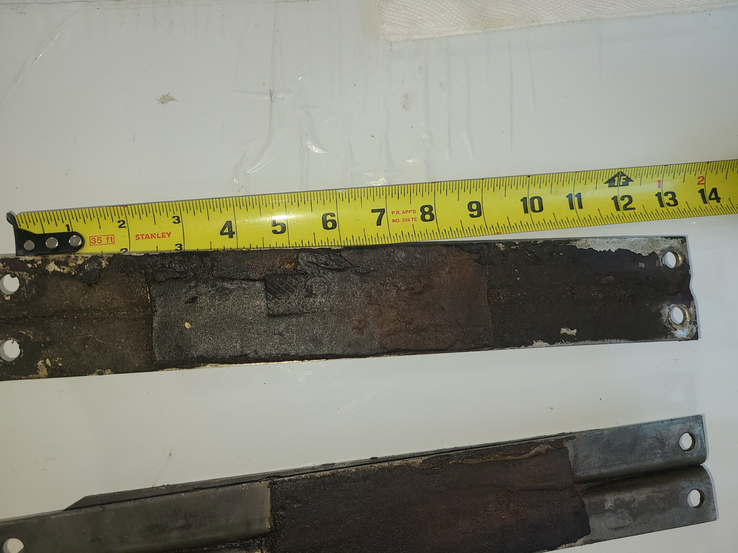

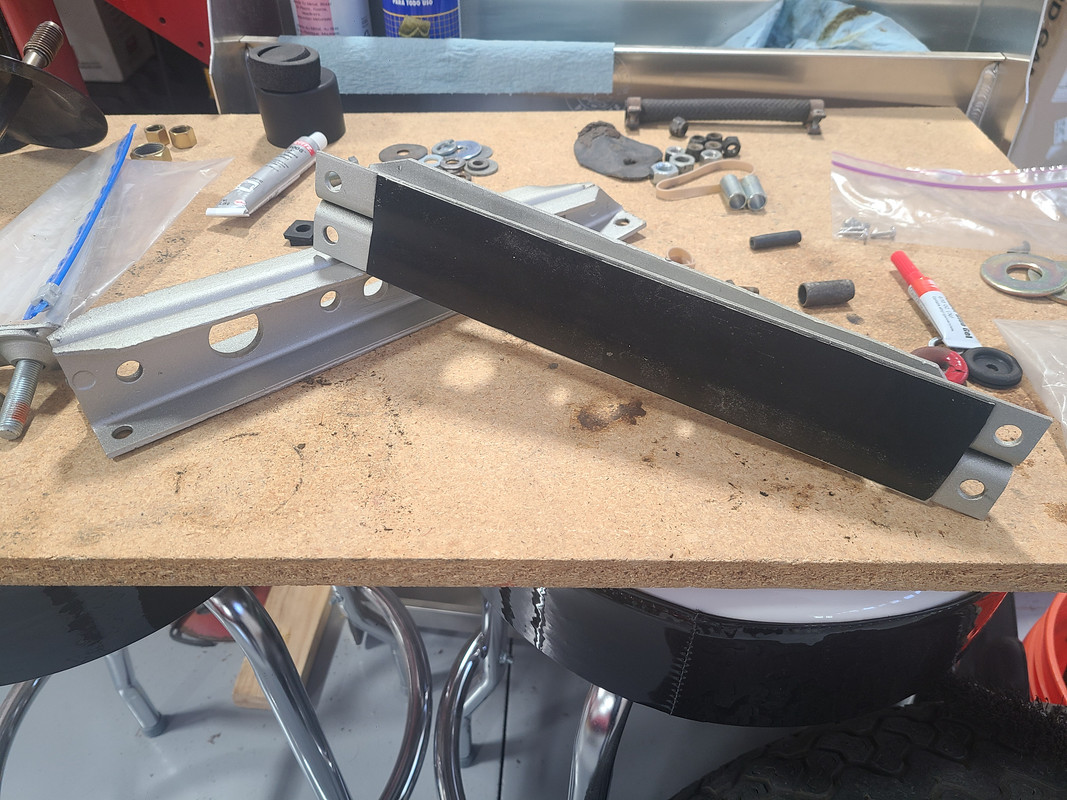

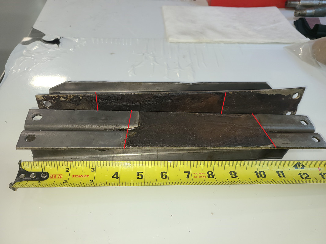

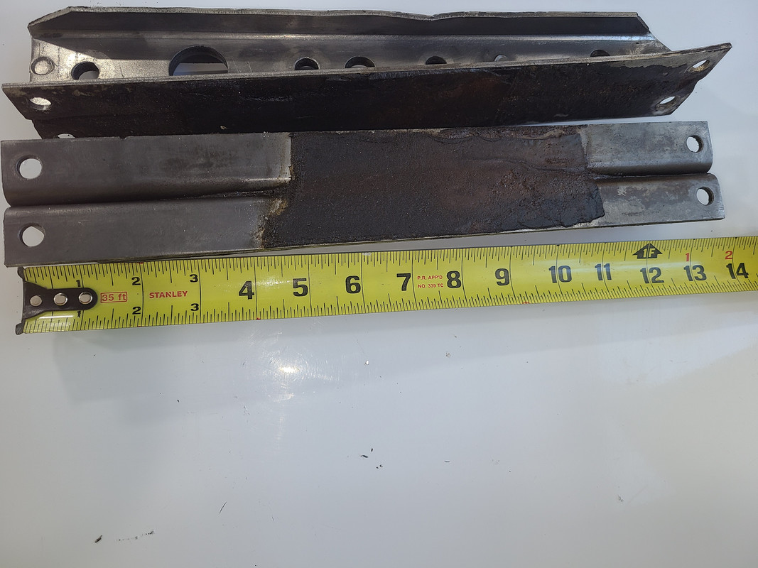

I believe these are anti-squeak pads.
I also glued a section of closed-cell rubber to them

Hi Craig,
many thanks for sending the pics of the rubber fitted to the reaction bracket.
I guessing thickness is about same as bracket flange?

Craig Balzer
- Posts: 92
#5 Re: Torsion bar reaction bracket - Buffer
Colin
I had purchased a sheet of thin (1/16" thick- ??) closed cell rubber when I was restoring the instrument panel. There is a long narrow stretch of rubber at the bottom which I believe was a light and/or dust shield. My original crumbled to pieces/dust at the slightest touch
I simply cut two sections to fit the bottom of the torsion bar brackets and glued them in place. I imagine the weight of car will squish them pretty flat but will hopefully do their intended function without complaint.
