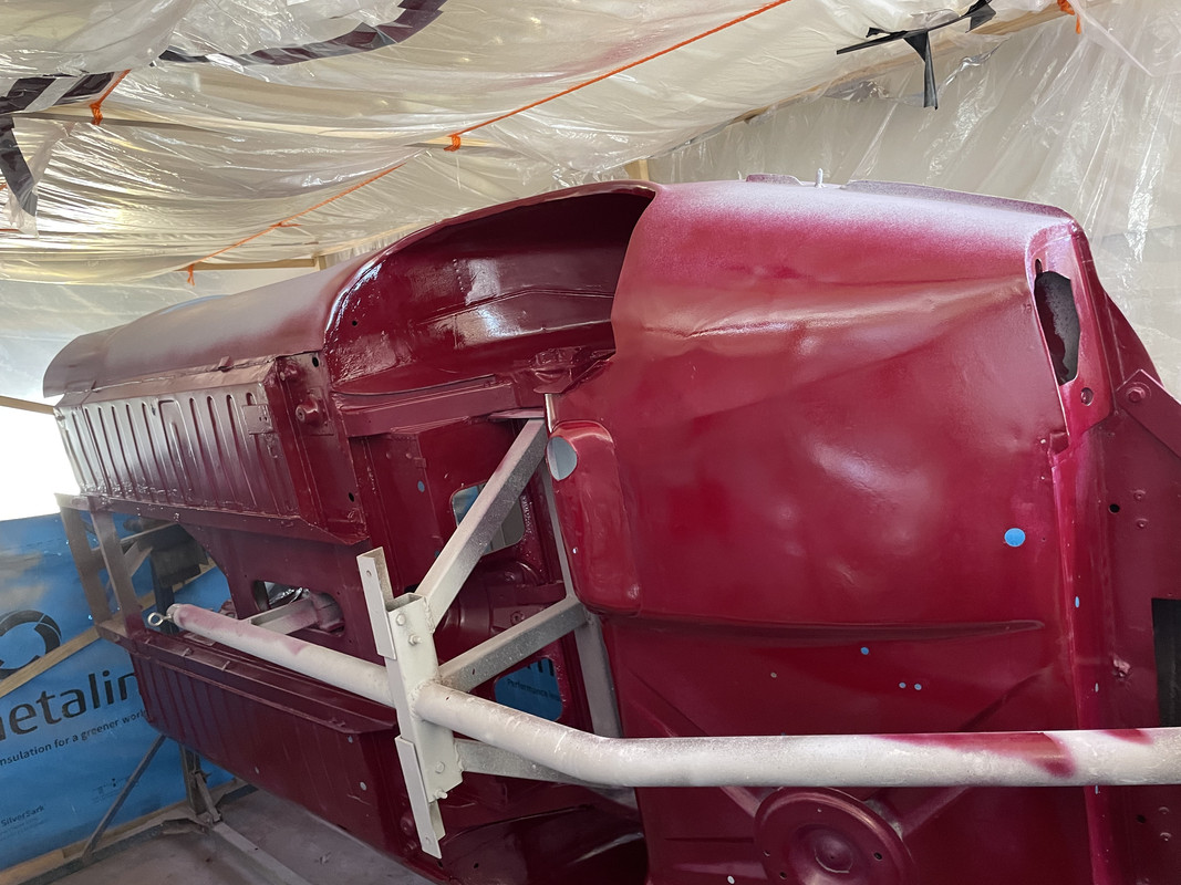

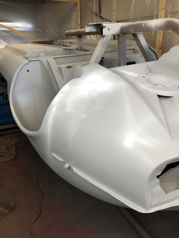

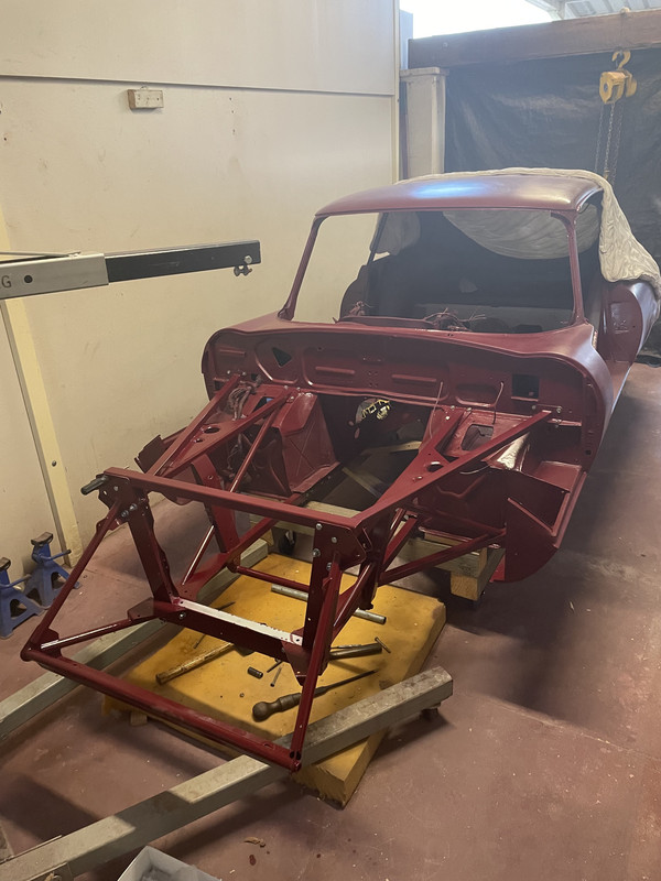

A couple of pics of the restoration so far.
It was originally painted regency red from factory (1971). During its life it was resprayed signal red.
I am reinstating the original colour as best I can knowing modern paints are different to 70's paints.
Some time ago I invested in a complete new front sub-frame as the drivers side (RHD) frame was damaged.
I'm pleased its off the rotisserie now, :bouncyyellow:
Colin

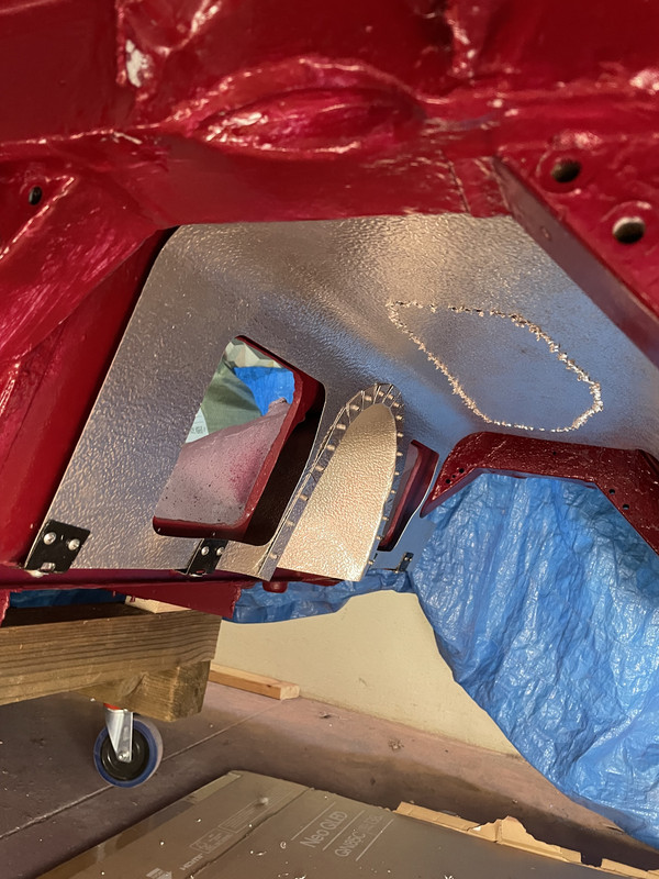

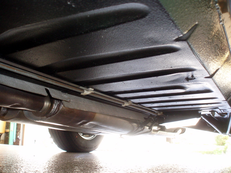

Colin

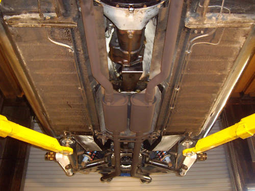

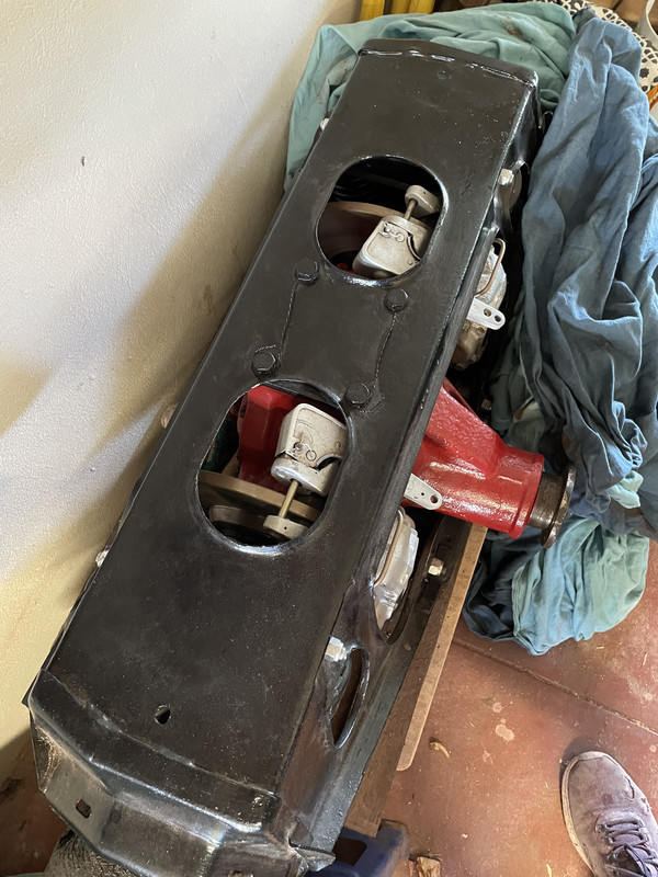

pics of iRS and heat shield prior to foam fitting and final assembly.
Colin

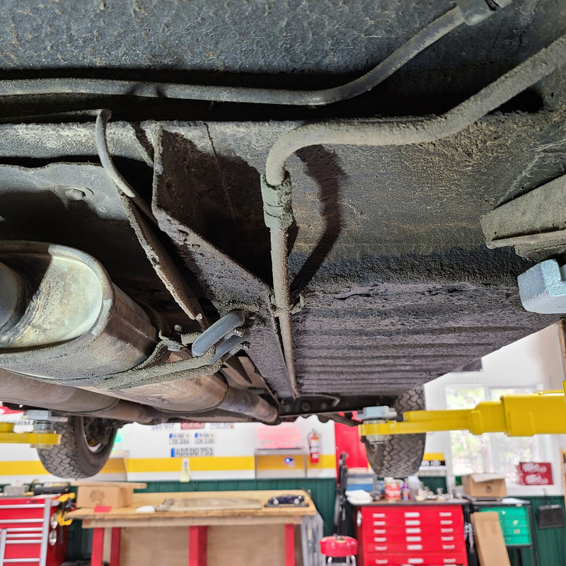

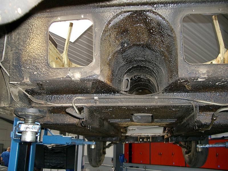

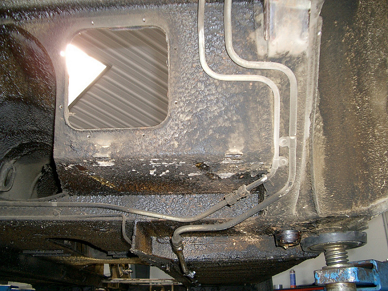

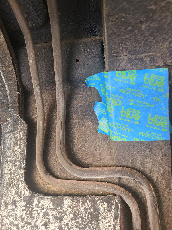

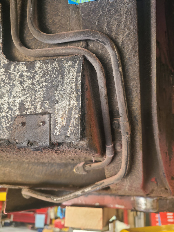

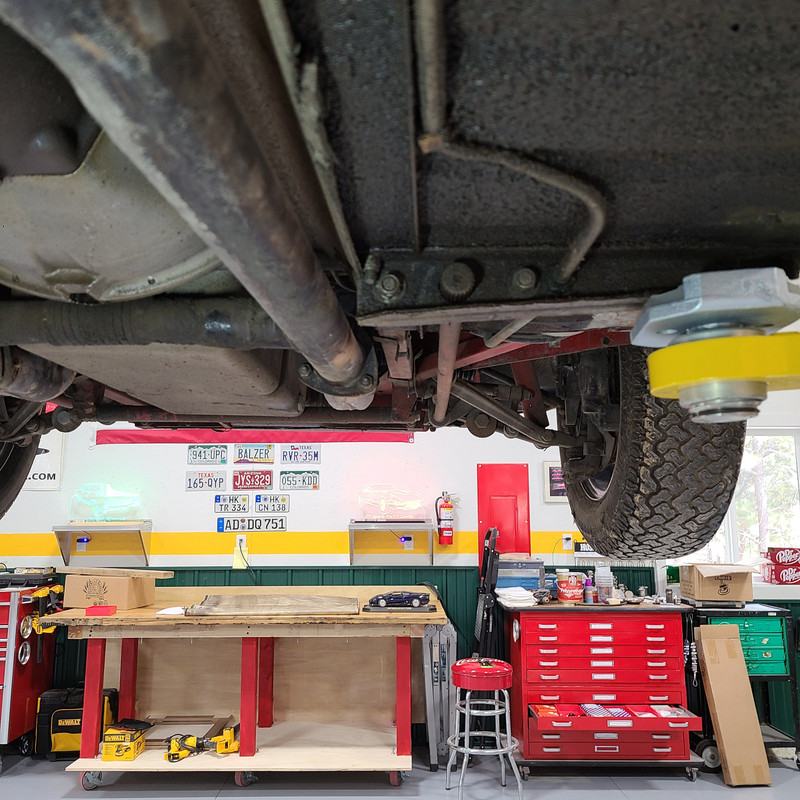

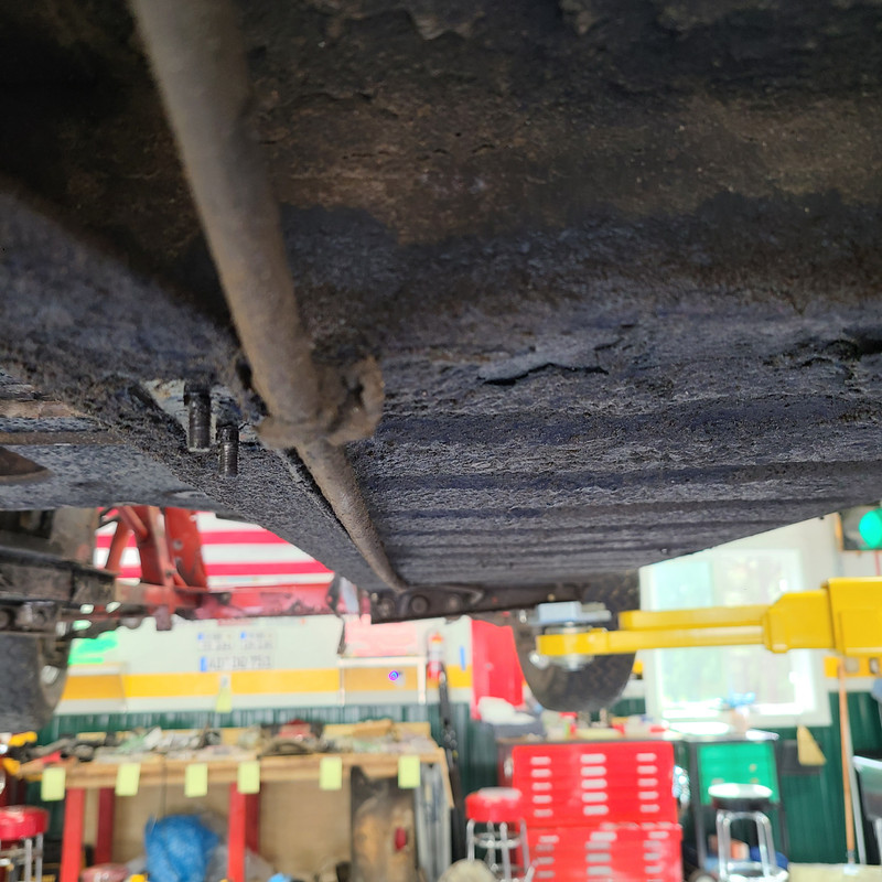

Post by Craig Balzer » Wed May 29, 2024 3:00 pm
Colin

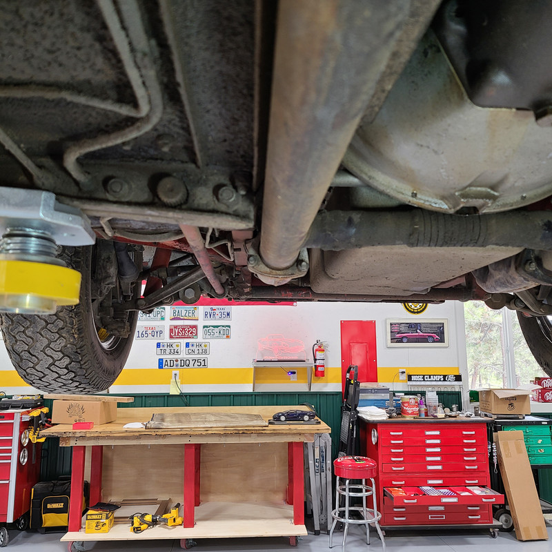

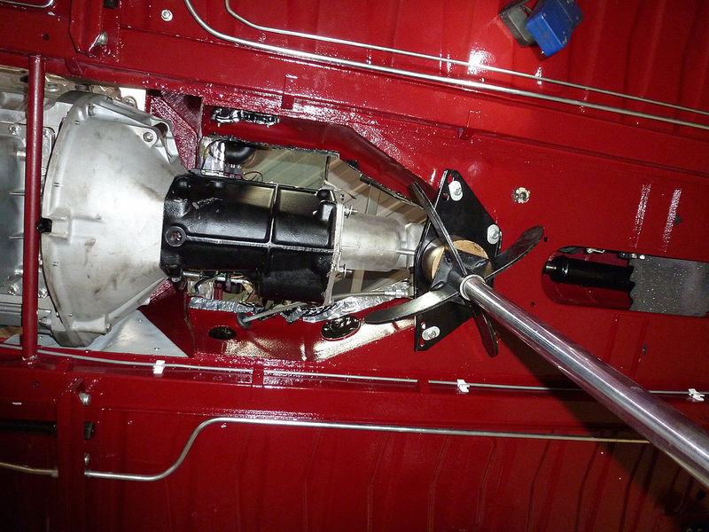

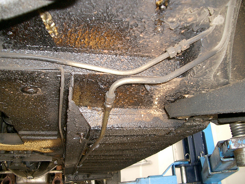

I am wrapping up my Series III restoration so I have a short ton of photos.
Here are a few I believe will help - I have more.
Details in captions
Craig Balzer

Post by Apprentice1975 » Wed May 29, 2024 10:45 pm
Hi Craig,
thank you for those pictures. This will help me a lot. If you have any more please post them too.
Kind regards,
Colin

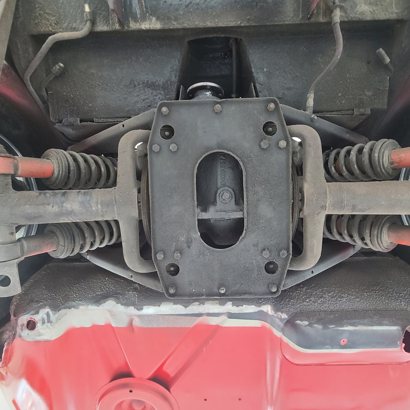

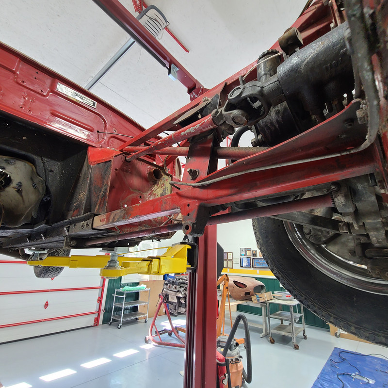

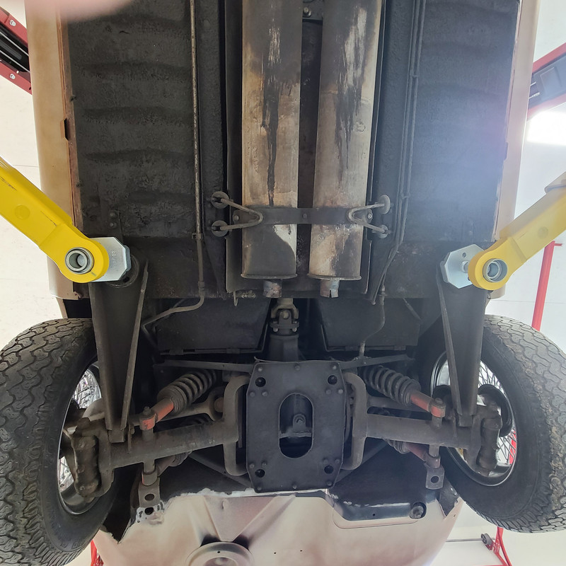

Craig Balzer
Posts: 92
#9 Re: Pre IRS installation

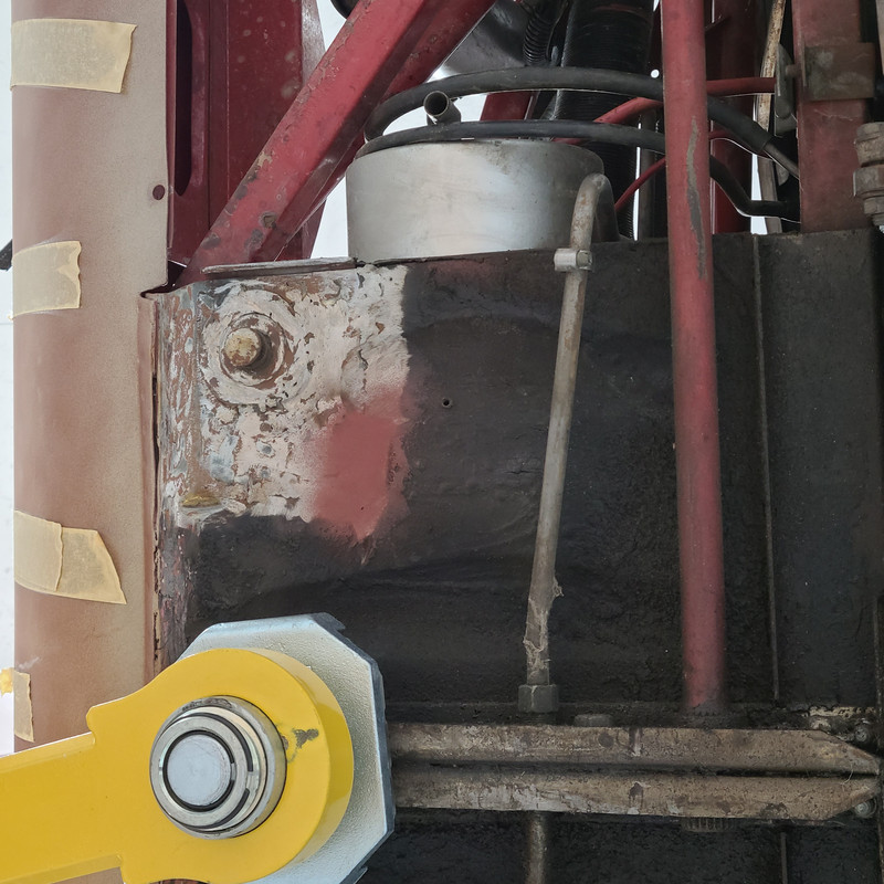

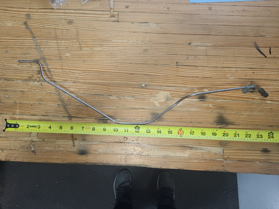

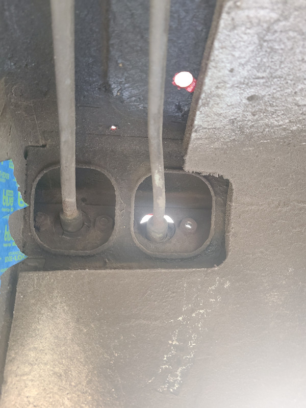

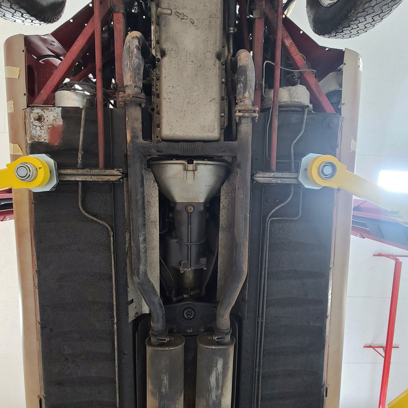

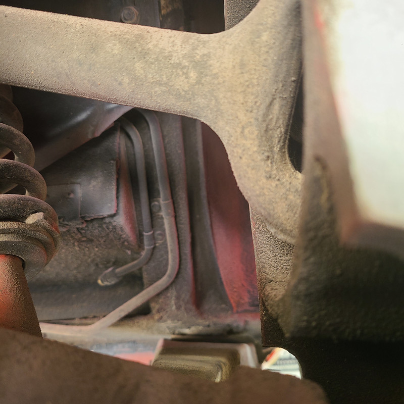

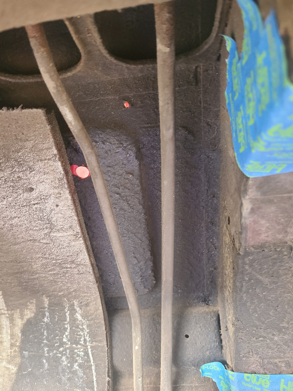

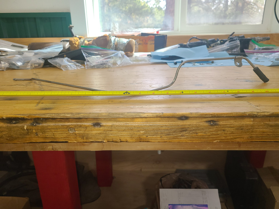

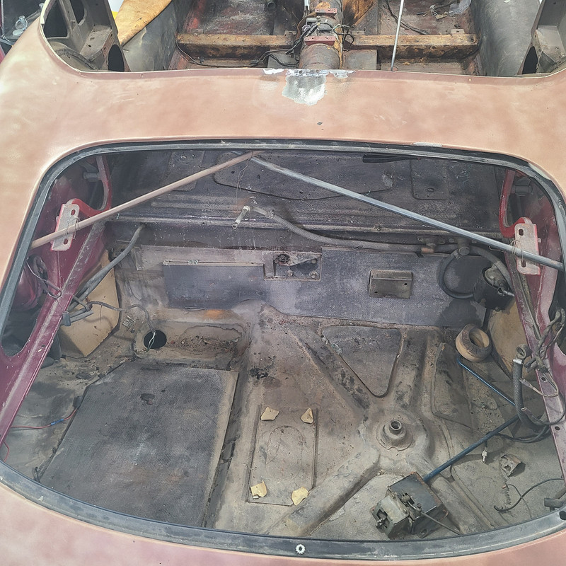

Post by Craig Balzer » Thu May 30, 2024 3:54 pm
Most of my other photos deal with the lines as they mount to the undercarriage, then pass though the torsion bar brackets and onward into the engine bay:
Craig Balzer
Colorado Springs, CO, USA

Post by Apprentice1975 » Fri May 31, 2024 2:28 am
Hi Craig,
that is very useful.
Thank you for taking the time and sending the pics.
Kind regards,
Colin

My experience with the alu sheet metal heat shield I bought, were not great. It looks nice, but when I fitted the IRS, there was not sufficient space around the diff and hand brake mechanism. I had to heavily modify it and still the space was so little that in the end I decided not to use it. Typical OEM quality... Perhaps yours is better, but I would double check.
In retrospect it would have been best to only use the large part of the alu sheet metal and use a flexible heat shield from glass fiber with alu toplayer around the diff end and use rivets to fit it in place. Then there will be plenty of space for the hand brake mechanism etc.

I keep looking at what i've done so far with the heat shield I'd purchased.
I got some heat resistant foam - self adhesive style , cut, shaped and stuck that on ,, sandwiched between shield and body.
Another forum member also has commented negatively about the aftermarket al heat shield.
Let's see what happens when I try install the IRS.

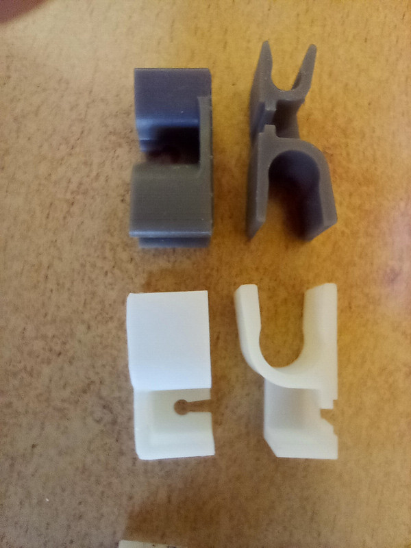

This reminded me to feedback to sngb about their fuel line clips
The return line clips (grey) are good. However the supply line clips (white) are too brittle, all broke trying to install them. Bought a 2nd lot, same.
Instead I use hose clips, retained by s/t screws that don't penetrate the floor.

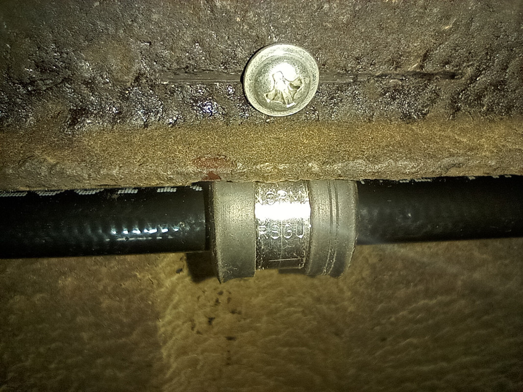

lowact
Posts: 772
#15 Re: Pre IRS installation
Post by lowact » Fri Jun 28, 2024 11:44 am
The stamped impressions in the floor pan leave gaps (~3 mm clear) between the floor and the supporting rails that run along each side of the tunnel. The ends of the hose clamps are pushed into these gaps at 30 cm intervals. The s/t screws, 4 mm dia. and 8 mm long incl. the tip, are drilled and tapped through the rails; the screws protrude through the clamp's mounting holes the full height of the gap, to the underneath of the floor.
Means for my supply line I have 4 supports instead of the oem 3. I’m using hose (for propane) instead of pipe, so I need the extra support. Hose is the same OD as the oem supply pipe.
