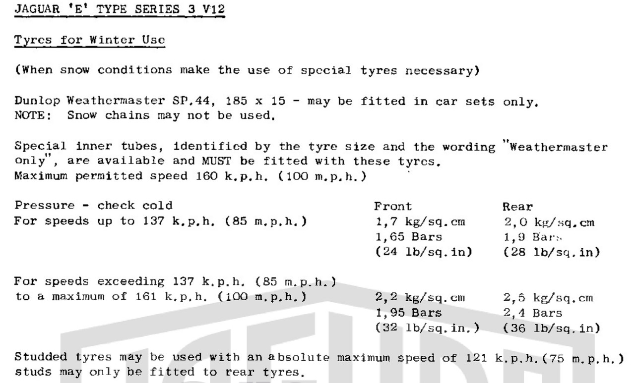

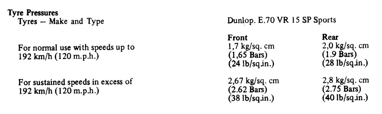

Here’s more variants for you. In the day you also had to decide pressures for normal use up to 120mph and sustained speeds in excess of 120mph (From S3 Manual E165 Issue2);
Then there were winter tyres to choose from (from S3 Service Bulletins);
Once you’ve read enough about tyres, you could also check your anti roll bar bushes and steering rack mounts whilst attending to the wheel track/alignment.
