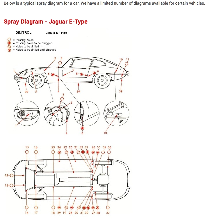

Dinitrol produced a chart showing where to apply rust proofing to an E-Type shell. It guided me to the various closed and semi closed box sections where, if unchecked, rust can start and eventually burst out. I think there is a copy in the knowledge base.

You said: "Dinitrol produced a chart showing where to apply rust proofing to an E-Type shell."
I did a cursory check of their website but couldn't find the chart.
Do you have a link?

#7 Re: Underbody protection
