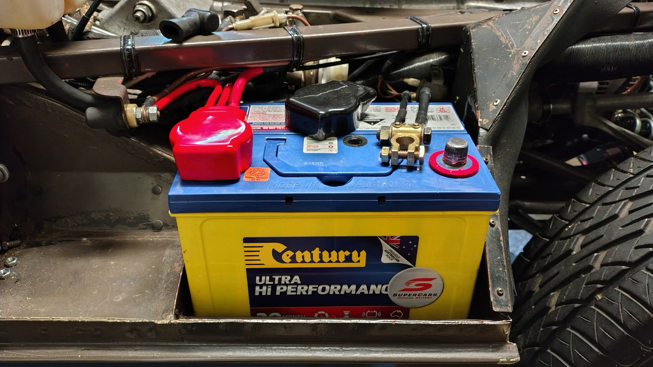

My existing battery is Century NS70LX MF with 720 CCA, 150 RC, 82 Ah, the largest I could fit. I.e. is a tad more than 75 Ah. Polarity is “C” which has the +ve terminal at front-right; or back-left if you turn it around, which was my oem arrangement.
With my oem arrangement, such a full size battery causes the positive terminal to be too close to the frame rail and the adjacent positive post to be too close and overcrowded. Will be improved by using a “D” polarity battery instead, i.e. with the positive terminal at back-right. This photo is showing that my new configuration is wrong for my existing battery:
