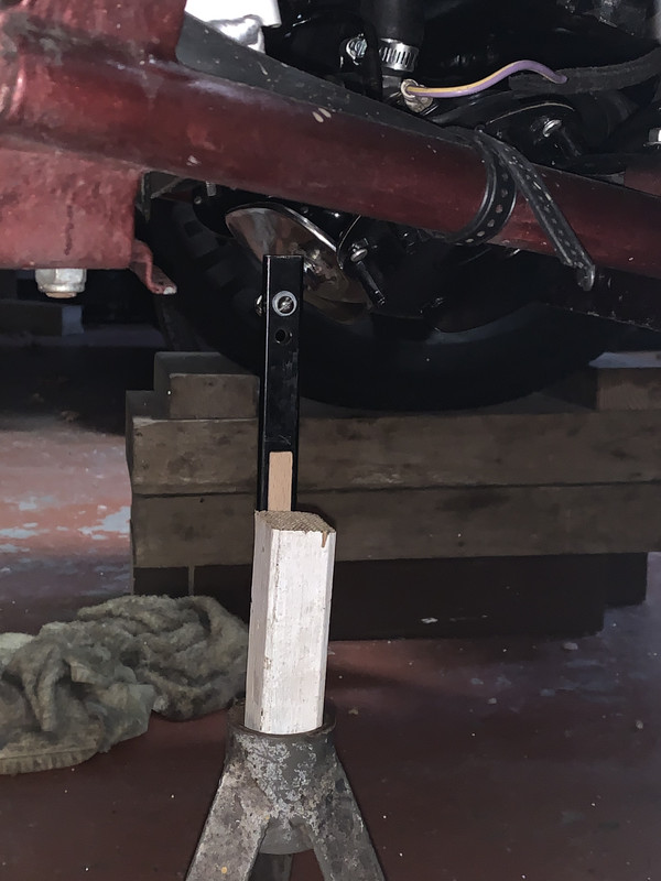

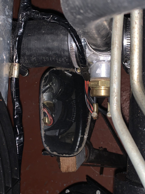

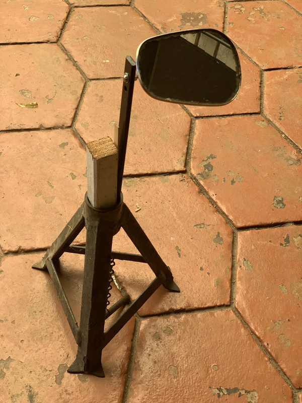

Two things, first a question for Marek, do you have a source for the old timing mark from an XJS? They are not common down here and I wondered if you have a part number?
As an alternative solution, try mounting a mirror to see the timing marks from above. I think these photos will help you see how I made it work. It is clearer than the picture shows once the strobe light is directed at it, which is done from above.
An alternative is to use a flexible camera endoscope, designed to look inside box sections etc and now available to fit to a phone. I haven’t tried this but I have heard that others have had success. I may try this out myself but the mirror works for me.
Sorry if I am late to the party but I hope this helps.
