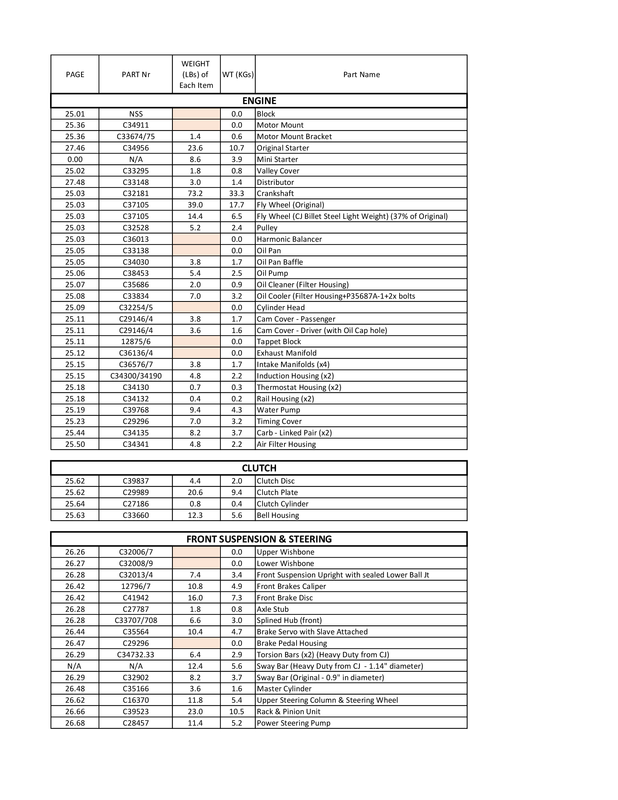

#7 Re: V12 Engine weight
The weights of the V12 engine, tranny, and other various and sundry components comes up regularly both here and on Jag-Lovers.
I am nearing the completion of the restoration of my 72 Series III OTS. I made a concerted effort to capture the weights of items as I disassembled and now reassembling the Jag. A few items were already re-installed and I forgot to capture their weight. The IRS remains to be restored
For some reason, the PDF only captured the first of three pages. Anybody know how I can correct this??
