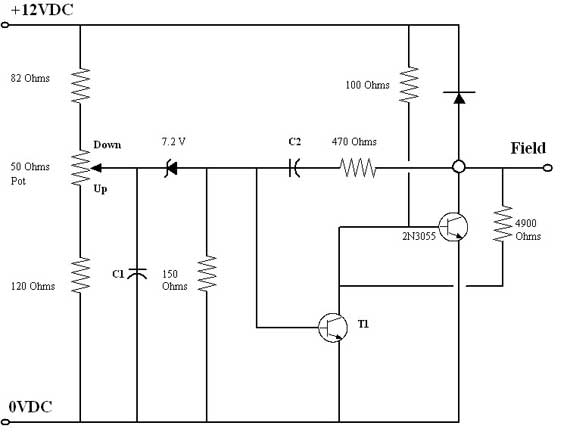

You probably need to know whether you have an original regulator or a repro. The originals are very simple and easy to repair and the web has plenty of info already published for you to achieve this. With a repro, you need to go back to he original vendor and get a circuit diagram for it. For all we know, what you have there may not be openable, settable or even alterable.
Here is what you should be able to see inside if it is an original:-
