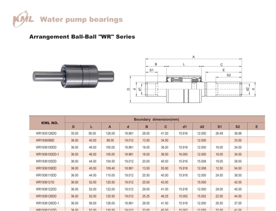

These brgs are only unobtainium because Jaguar heritage part suppliers don’t stock them, you can still buy them from bearing suppliers; because “water pump bearings” are a bog standard thing that are used universally by everybody for everything. Available in an almost infinite range of sizes. So just take yr old bearing into a brg supply shop, they will look at, measure it and give you from a catalogue one that is exactly the same for a fraction of the cost that you would pay a Jaguar heritage parts supplier. E.g.:
Note that a Jaguar (or Mercedes or GM …) P/N is meaningless to a bearing supplier.

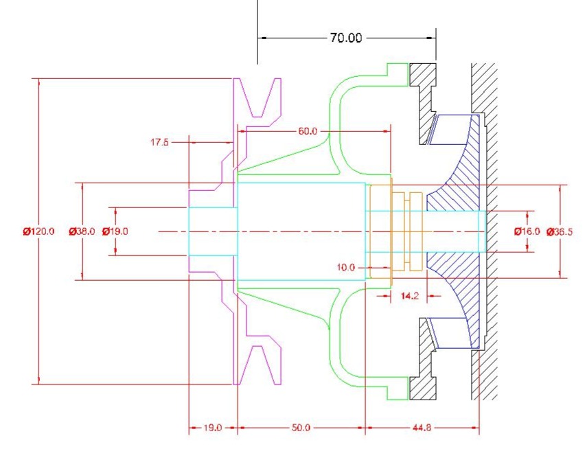

In my case I made it even more difficult; because I was trimming my water pump(to line up my modified pulley arrangement), for it to fit flush and neat I needed a bearing that was not a standard retail size ...
To source this I had to find a manufacturer who was prepared to sell me just two (one spare). I eventually stumbled across Jason (forget his last name) from Outer Mongolia. He was very obliging, even sent me a screen shot of their AutoCAD drawing showing the dimensions and tolerances. The two bearings that duly arrived via DHL were the best quality of this type of brg I’ve ever seen. I.e.: I still had to trim a couple of millimeters off the end of the output shaft; the metal was so hard we couldn’t cut it, had to get it ground off. Overall including freight) it cost me about a 1/3 of the local asking price for closest available size.
