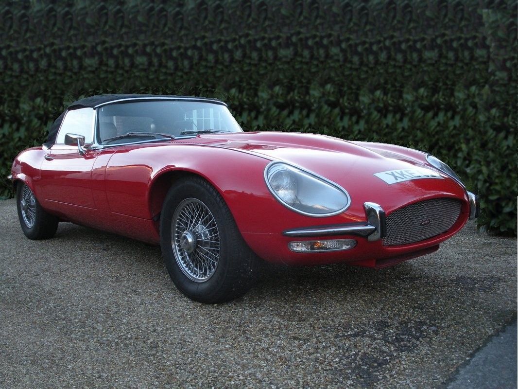

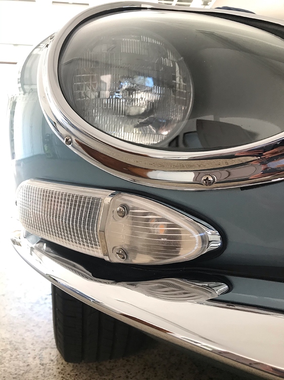

Series 1 front indicators don't fit a series 3 bonnet. The chrome housings they attach to are different and they mount onto the bonnet over the bumper, not under the bumper, where the larger series 2 and 3 lights attach. Additionally, they fit snugly into a recess in the series 1 front bumper which the series 3 bumper hasn't got, so even if you were to retrofit some, you'd have to patch up the holes under bumper and fit new series 1 bumpers. Essentially, you'd need to look like a series 1 bonnet underpan at the sides but with series 3 flared wings.
If you want clear lenses, then fit clear lenses. If you want different shaped indicators, then the solution involves sheet metalwork somewhere along the lines.
Here is an example of a reimported series 3 car with MX5 front indicators with series 1 front bumpers upside down to fit around the new indicators.
Here is a series 1 bonnet showing L652 lights and the bumper recess
