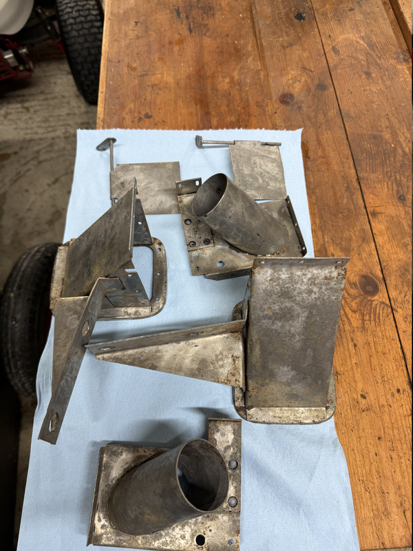

Decided to refurbish the fresh air vents on my series 3. Removed them (needs to be done with care as the suspension arms are attached to the frame with the same bolts), drilled out the pop rivets, removed the springs and stand-off posts for the control flaps, stripped off the paint, then before de-rusting:

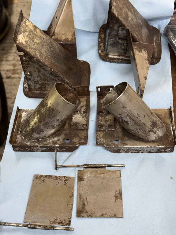

Then rather than use an expensive de-rusting agent, I used a mixture of 1Litre hot water to 100g of citric acid and 63g of sodium bicarbonate. Soak for a few hours and agitate occasionally with a wire brush:

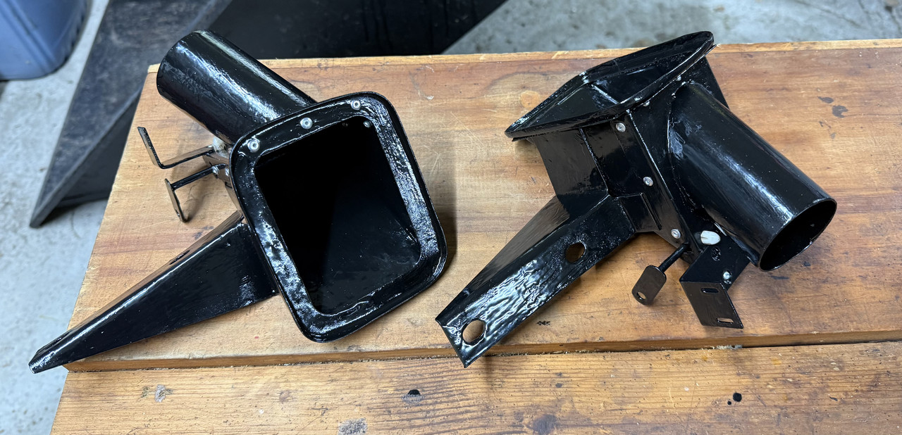

Then paint, re-assemble and pop rivet
Cheaper than buying new ones! Hope the de-rusting tip helps a few people.
