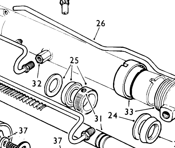

LHD means for you the leak is from the non-pinion end. When reassembling the rack, if the hole in the piston stop (31) is not sufficiently aligned, the consequence can be leakage from the non-pinion end.
