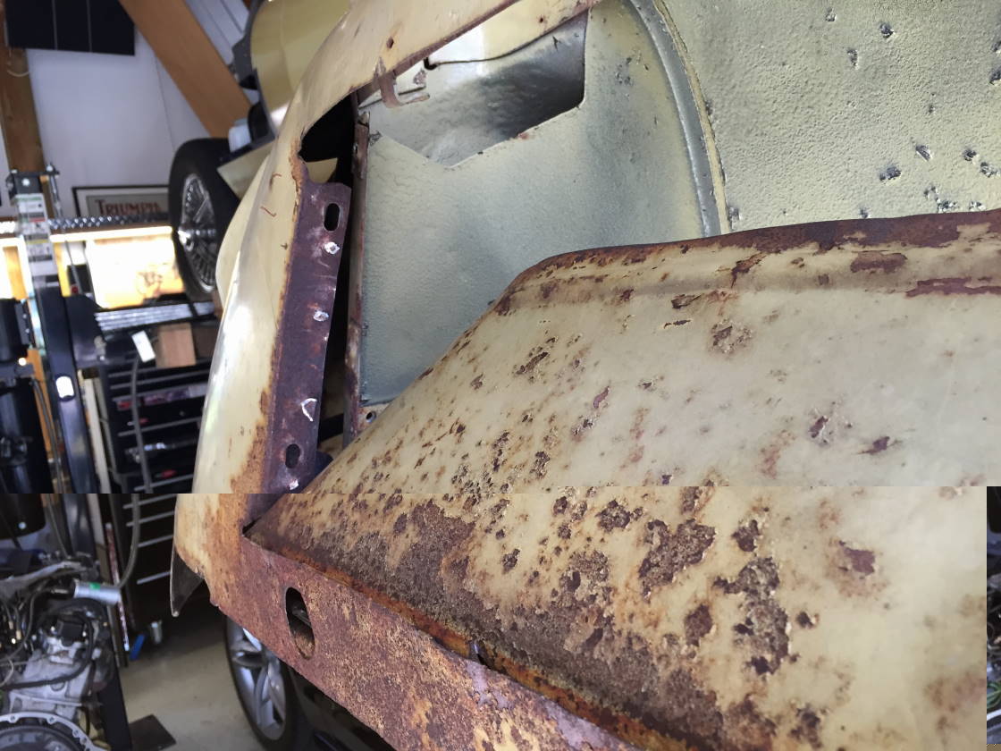

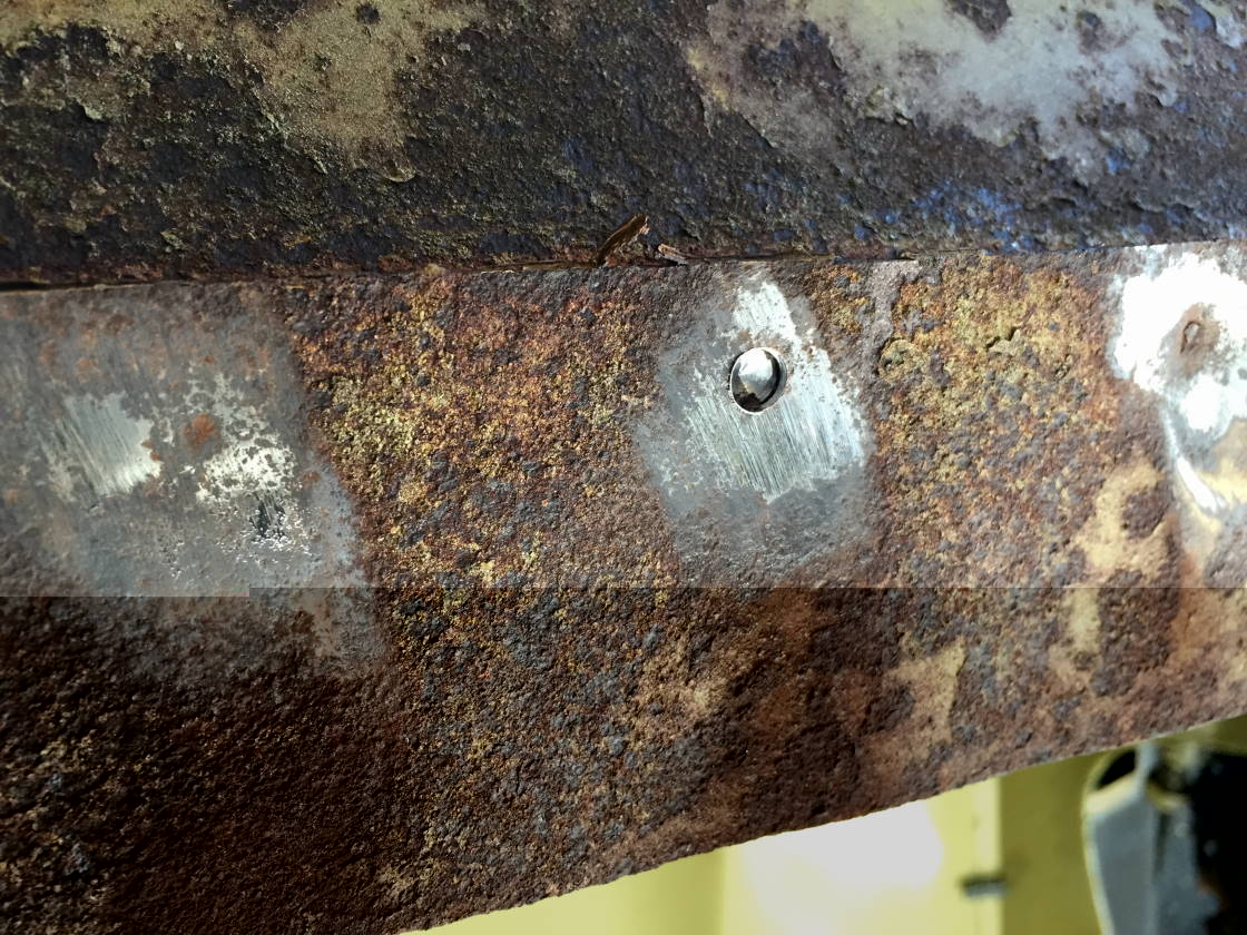

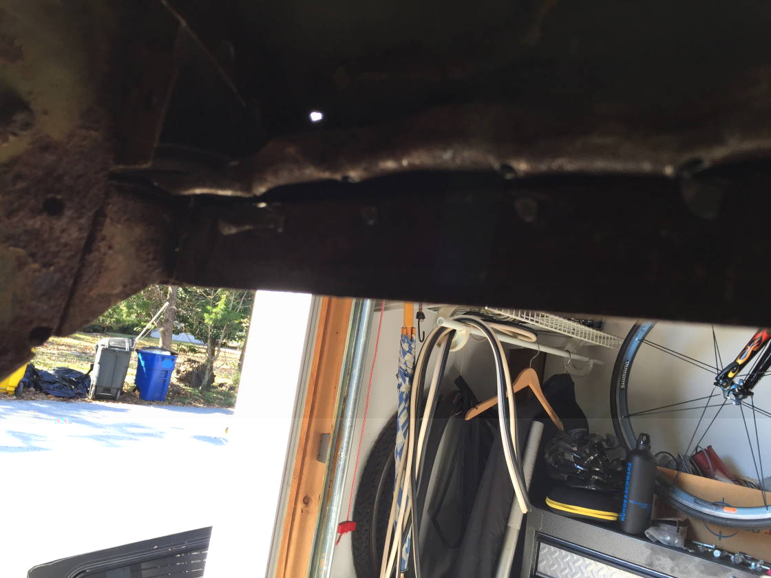

Ole-xke1974
Posts: 181
#7 Re: under bonnet air scoop
Post by Ole-xke1974 » Sun Sep 11, 2016 11:49 am
Mine was spot welded at the rear in two rows as well as at both sides. No reason to think this is not factory, so I repeated when replacing it.
Scoop spot welds_1
Scoop spot welds_2
Scoop spot welds_3
