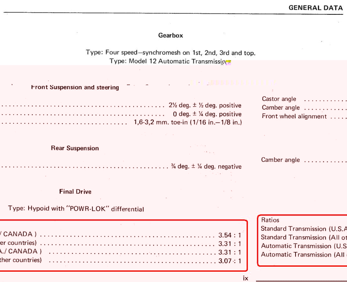

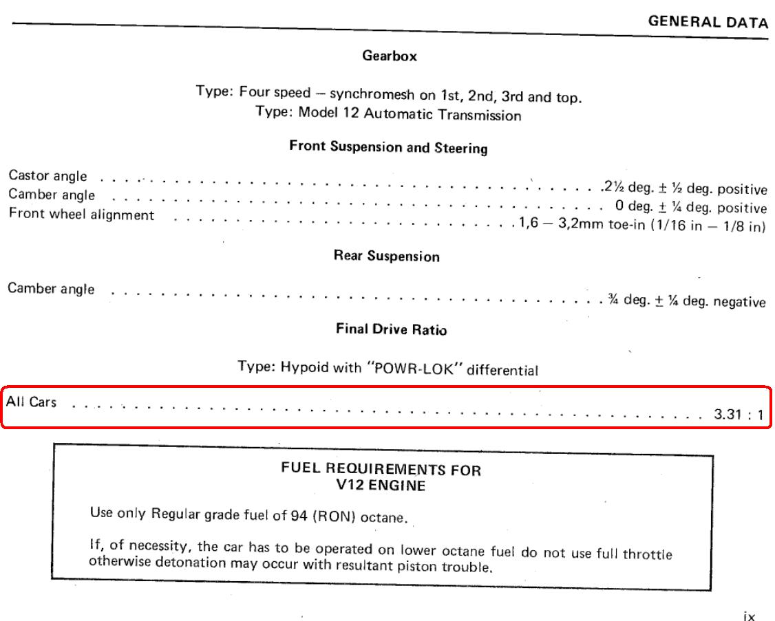

#7 Re: UK Auto - Diff Ratio
Hello Pete,
As this section of the Forum is related to S3 cars, SWB doesn't come into it, nor does 6 cylinders, except for four S3s with 6 cylinder engines that were built before that form being dropped. Accordingly, my information is related to S3 V12 cars only, which I believe is the Series Garry is inquiring about.
First picture below is General Data for Late S3s USA specification cars. Second picture is General Data for very early S3s showing World Wide final drive specification.
