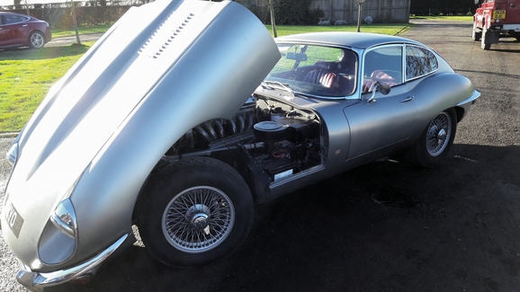

When I have some more miles, I shall continue the thread with final tuning. This will be messing around with the 123-tune to see how much advance I can get and playing with the carbs.
Hopefully I can get some serious torque without any pinking.
So far all the signs are promising.
