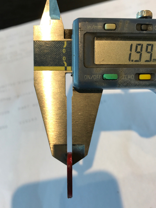

We have done a bit of research into this subject and can advise what we think on the washer thickness. We think an original spacer washer for E-type (Part number C10193) is circa 1.99mm thick. This measurement comes from a "barn find" type car that we use to measure original parts. The parts that we stock both in the BD36166FK kit and as the part number on its own is coming in at 1.96mm. Given a there is a bit of residual paint on the original we are happy that our washer is within tolerance of the original.
I have attached a couple of pictures for reference (the washer with the red edge is original) on this and hope that this is helpful.

Bear in mind that all Jaguar original parts were manufactured to imperial measurements (e.g. 1.99mm = 5/64"). Modern manufacturing is built around the metric system so you can expect differences as they round up or down to whatever stock they can purchase. This was a major problem with clutch servo seal kits which were manufactured in China I believe. They were made to the closest metric measure but were undersize for the original servo bore, hence they leaked.
To get steel or other stock made to imperial measure for use in E-Type parts would be hugely expensive so there has to be a compromise somewhere.

Steel rolling thickness tolerances are typically plus or minus 0.05mm, or 0.002", so this would pretty much cover the variation found.
My concern is more regarding the material properties and chemical composition and I think I'd be right in saying that this is probably where most of the quality issues lie. Simply making comparative measurements is not good enough.
I have a few original washers and have carried out comparative bend tests and found the originals to be much stronger.

A picture says more than thousand words... 2mm
I already bought the washers fram SNG and now i found the kit called (Bonnet Fixing Kit) there also, wish I had knew that when I ordered the washers :bigrin:
