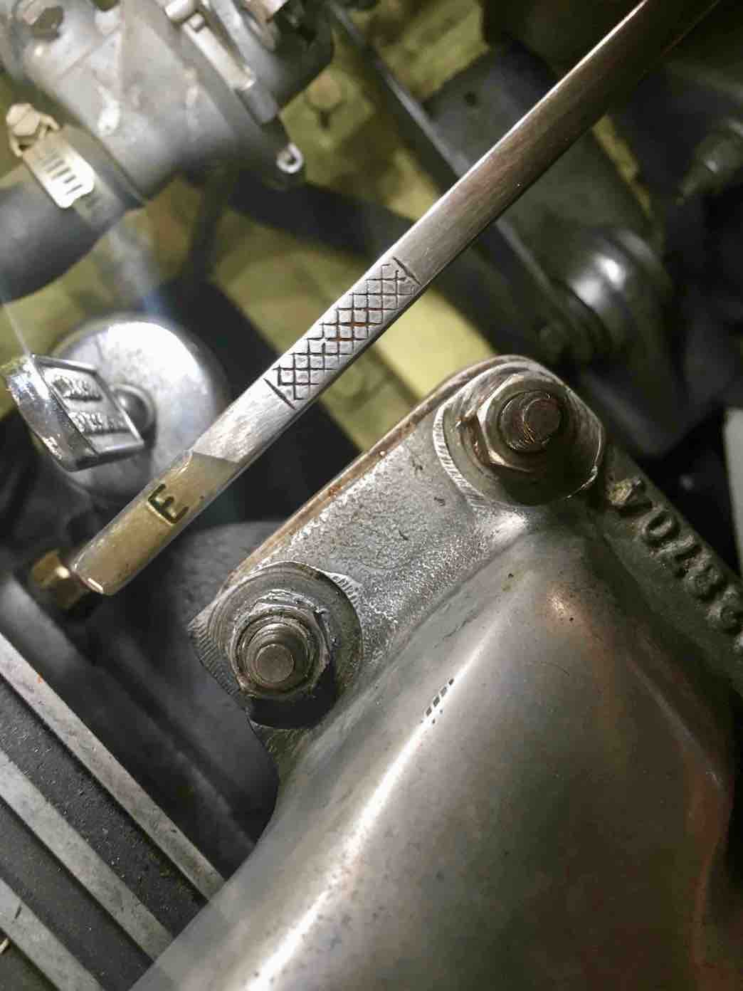

As promised, I checked my engine oil dipstick and I join 3 pictures. The 2 first ones are the dipstick under different angle. The third one is the level displayed by the dipstick for 8.5L of oil.

I'd say it looks bent to me. That could mean you're not going straight into the sump. Do you have to push it hard to get it in? My car is a '69 2+2, and your dipstick looks different. Certainly different at the top where you pull it out. Maybe they were different in the American market? But if you've put in the amount of oil you say, it should be at the top of the hatch so something is wrong. Can't get to my dipstick at the moment to take a pic, but maybe someone else with a 4.2 can post a pic of their dipstick angle?

If the dipstick is hitting the baffle you will be able to feel it when you put it in the last few inches of travel.
I would have thought your dipstick would show no oil at all if it was hitting the baffle.
If you have the correct amount of oil in the engine and the dip stick is in the sump oil, I would be tempted to think about tapping the tube further in an cm or two. You have the perfect opportunity to adjust the dipstick to give an accurate reading.
