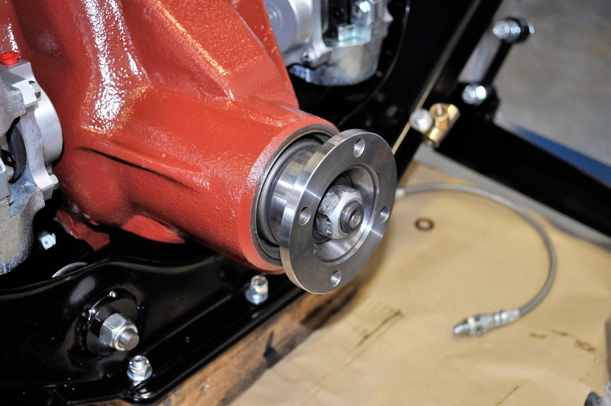

By coincidence, I've just had our IRS overhauled. The diff had been converted to 3.07 in the USA back in the mid 1990s and, on opening the diff up for the seals to be done, we noted it was a Dana 44 crownwheel/pinion (with a 26 spline shaft). The car had done only 10,000 miles since that time but there was no sign of wear. It was also very quiet (which we were keen not to undo).

He may well have been referring to my car (which Southern Classics has just done an IRS overhaul on). The firm he used to refurbish the differential noted it had a Dana Crownwheel and Pinion (which meant it had a 26 Spline Yoke at the end of the Crownwheel shaft). Given the diff was running so quietly and the 3.07 Crown Wheel and Pinion were virtually unworn, we decided to leave it in-situ and just replace the seals. Steve then managed to source a superb 26 spline Flange of the correct size and hole spacing. See picture below.
