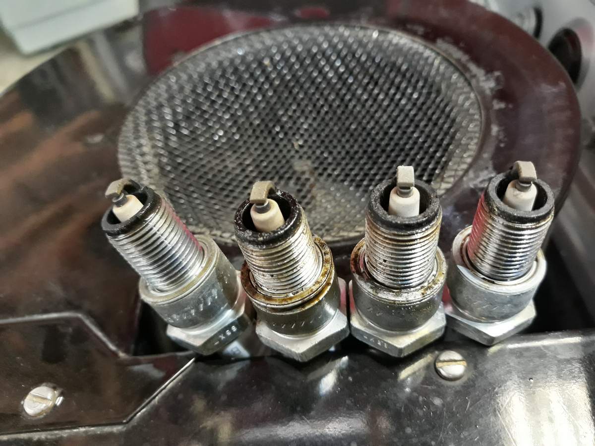

I have just pulled all the plugs on the V12 after a 20 mile run in fairly cool weather and thought it would be helpful if a member or two could please advise what fuel mixture adjustments they would recommend on each of the four Strombergs ....and any other adjustment. The ignition timing is OK (slightly advanced versus the ROM spec), new dizzy cap, fairly new leads, fairly new plugs, great spark, only centrifugal advance (I have "plugged" the vacuum retard hose, given that the retard is an unnecessary complication), can't detect any vacuum or other leaks, fuel pump seems to be delivering OK....
Colours below refer to the central electrode, plugs numbered from front of engine
A Bank
1. White on one side, grey on the other side
2. Light grey on one side, dark grey on the other side
3. White on one side, light grey on other side
4. Dark grey to black all round
5. White on one side, dark grey on the other side
6. Dark grey all round
B Bank
1. White/light grey
2. White/light grey
3. White/light grey
4. Dark grey
5. Dark grey
6. Light grey
I should also mention that there's a flatspot at about 3,000 rpm (which was why I pulled the plugs)
I look forward to your welcome feedback.
Best regards
Chris

From this info, it seems there is a problem with the front carb on the B-bank. Seems to be running lean almost as if its not feeding any fuel (or way too little).
I would remove that air filter, and while looking into that carb (with safety glasses), rev it up briefly with much throttle and observe if 1) the air valve (that cylindrical "piston" in front) lifts as much as the rear carb; 2) you can see fuel being drawn into the carb.
It might also be worth while to check if the butterfly on that carb actually opens before you start. If somehow the throttle linkage came loose....

Even with unleaded spark plugs can still tell something. (I'm certainly no spark plug whisperer...)
It most certainly will tell you if the piston is running rich = very black
Too lean = too white and clean
I can not see how a spark plug can tell much about timing. Maybe there's something when the engine detonates a lot?

Here's an example of my car 's plugs, which I recon is one of the best tuned S3's in South Africa - IMHO.
Inner ones #2 on each bank, outer ones, #6 on each bank:
Relevant info;
  • The carbs on my car are perfectly balanced;
  • fueling set as good as I can;
  • needles changed to reduce overfuelling on full throttle (it was making visible black smoke on full throttle pulls);
  • Lumenition ignition;
  • Vacuum advance (vacuum direct from intake manifold);
  • I add 500mL of 2-stroke oil to the fuel every time I fill up (only when fuel gauge is well below 0)
Best Regards
Philip

Following your advice, I checked that the front LH carb was operating in unison with rear LH carb etc. All fine.
Then set the mix using the screwdriver piston lift method. Front RH carb was definitely running too lean, the other carbs only needed minor adjustment. Went for a good run, plugs all perfect and no flat spot.
If this success continues what will I do with my spare time!
All the best
Chris
