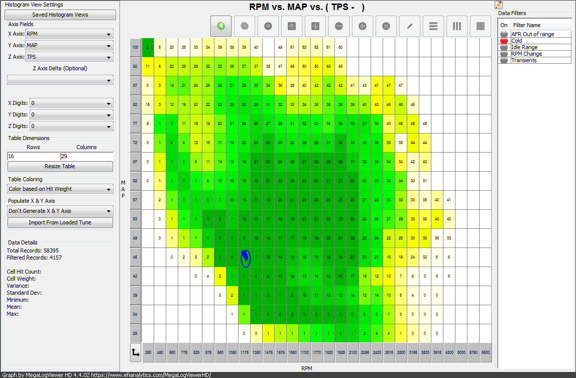

Posts: 1763
#34 Re: Black smoke Series 3 2+2
Post by MarekH » Fri Mar 27, 2020 12:31 pm
Ultimately, the vacuum comes from the same place, so ported vacuum is manifold vacuum when the throttle is opened any significant amount. At very low throttle openings, ported vacuum partially throws away the vacuum signal and at closed throttle (e.g. when stopped at the traffic lights idling), it completely throws away the vacuum signal.
If connected to an advance capsule, this simply means you engine runs more retarded when the throttle is shut (or nearly shut) and so generates more heat at minimal throttle openings. You'll be needlessly generating engine heat when stationary (i.e. no airflow and minimal waterflow) just when you need your cooling system the most. As Philip points out, the engine runs less efficiently with less advance and so you are throwing money and performance down the drain.
How much are you throwing away?
Lets look at a few graphs....
The first records how open the throttle is so you can get a handle on how far open the throttle is at different revs and different engine loads (MAP=0 is zero load (e.g. overrun) and MAP=100 is heavy load (steep uphill, pedal thumped hard to the metal...))
tps for ported vac graph.png (57.73 KiB) Viewed 30038 times
This tells us that the throttle is roughly half open at full load and medium revs; it is about a third open at heavy load and low revs; it is shut at idle (blue spot); it is shut at low revs; it generally spends most time about 20% open to 35% open.
The second graph records the pressure at the ported vacuum port. 100 = atmospheric pressure, so there is no vacuum signal if the graph reads 100 and there is maximum vacuum signal if the graph reads 0. Manifold vacuum is the left hand axis, so what you are looking for is how different the numbers in the boxes are from the number on the y axis.
ported vac graph.png (61.46 KiB) Viewed 30038 times
So at high engine loads, when the throttle is most certainly open, the ported vacuum equals manifold vacuum - all the numbers in the top row are between 92 and 100, so ported vacuum does nothing for you - it IS manifold vacuum anyway; if you draw a diagonal line from top left to bottom right, anywhere above that line ported vacuum equals manifold vacuum, so again, it does nothing for you. Below that diagonal line, the lower the revs and the lighter the load, the throttle plate is more closed on average and the ported vacuum signal returned is being thrown away and the engine is going to run more more retarded, generating more heat. For example, at 1700rpm with the engine 50% loaded, the vacuum signal is on average 100-73 = 27, whereas with manifold vacuum it would be 100-49 = 51, so you are throwing away half of your vacuum signal for advance when cruising.
Essentially having some vacuum advance is better than none which is the default etype v12 position, and everyone who fits ported vacuum waxes lyrical about how much better it is than the vacuum retard capsule that was fitted. What Philip keeps trying to remind you is that having full vacuum advance is even better. It is better in each cell by how much (100-MAP) is greater than the (100- number in the table) on the same row as the MAP figure on the left hand side.
There is no case where you get more vacuum advance with ported vacuum than you get with just straight manifold vacuum (MAP) so you are simply running more retarded than you need to, all other things being equal. Since you spend a significant amount at part throttle, you are throwing away much of your performance a significant amount of the time. When you put your foot down, ported vacuum equals manifold vacuum so being "ported" is nothing special - it's just regular normal manifold vacuum advance.

What Marek was kindly saying, in many words were: "You can safely connect to manifold vacuum". :bigrin:

Actually, that's not what I said, but it is almost certainly true. You don't want to over advance the engine no matter where you connect your vacuum to.
At very low engine loads, it is generally safer to see higher advance than the same amount of advance at higher engine loads.
The amount of advance is the same with either vacuum connection at medium to high engine loads. Manifold vacuum gives more advance at medium to low engine load than ported vacuum does.
If it idles at a higher speed due to the extra advance, then you can adjust the throttle plates to be a bit more closed and/or drop the static timing a bit.
