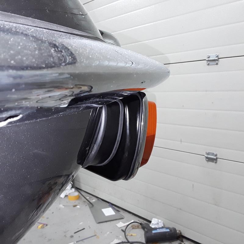

A little bit of an update. The Elan lights are now fitted.
Posts: 3842
#243 Re: Series 2 aesthetics
Post by Gfhug » Sat Mar 28, 2020 10:06 am
Simon, that looks very nice :yellow:
The slimmer central bumper works well, another good idea :salute:

Thanks chaps,
Marek,
I'd already bought the S2 complete units from Barratts so just needed the lenses. They were about £40 each.
The light housing is basically the same but without the reverse light bulb holder so I just added holders from RS Components which were £7 for 10.
I decided to swap the bullet connectors for Supaseal ones to prevent water ingress and also so the connections were less likely to get muddled up.
I like idea of integrated led units but decided to go the route of retaining individual bulbs just incase they ever need replacing.

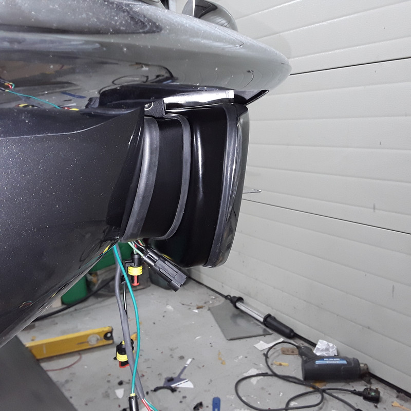

Jeff,
I'll take more pics when I get chance. They original lamp backing was used but the mounting holes altered to allow the lamp to tuck up under the bumper better and move inboard slightly. I then made black powder coated fillets to fill the gaps at the side with rubber seals.

Hi Jeff,
No drilling into the body. Everything I do in terms of "mods" on the car is with the proviso that it is reversible.
It was my intention to get the fillets painted body colour and use a different seal but Covid 19 got in the way of that plan. To make the best of the next 12 weeks I want to press on and get as much built up as possible and tested/working. I can always come back to the lights at a later date.
The filler pieces are attached to the existing bracket for the lights.
A few more pics as requested.

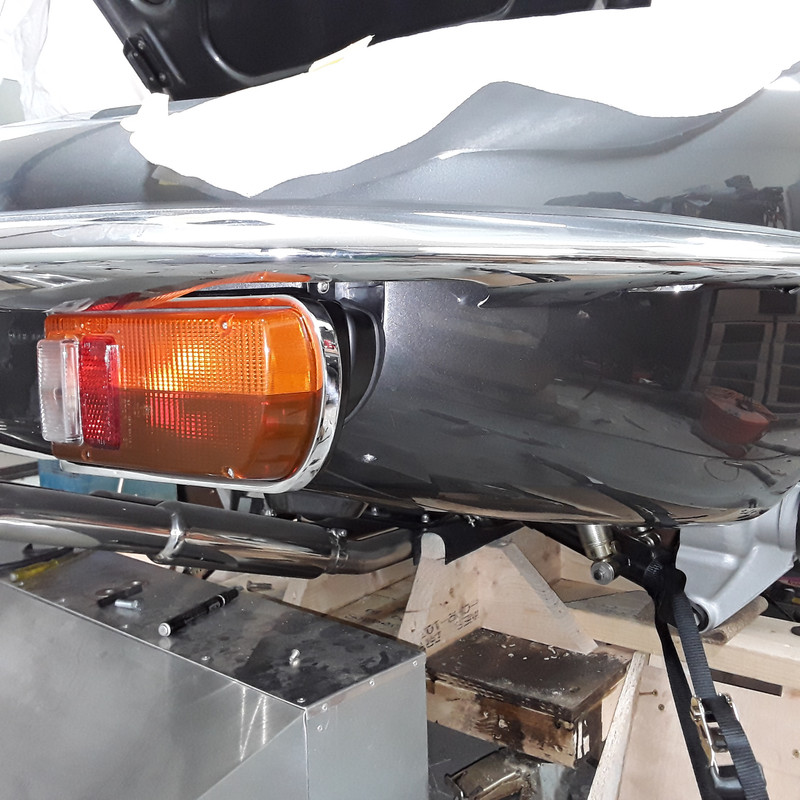

#253 Re: Series 2 aesthetics
Post by 288gto » Fri Apr 24, 2020 6:15 pm
Cheers Jeff,
Yours definitely follow the curve of the body better. All that is needed ( in my humble opinion ) is some sort of filler piece where the arrow is pointing to make them perfect.
