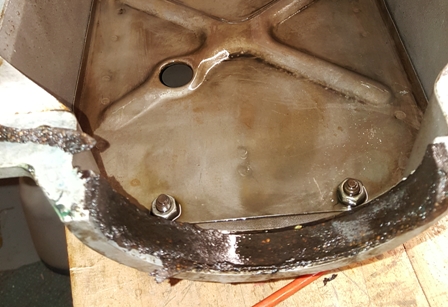

Well sump is now off and residing on my workshop bench.
The balancer came off with the £12 puller but the sump wasn't having any of it, even with the woodruff key in the 1 o'clock position.
I followed the video for removing reaction plate and the sump came down as expected and the cork gasket has disintegrated. (20 years since rebuild and only 4k miles since - car now has 51k)

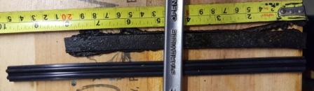

I read that some members recommend not cutting the rear sump rubber seal but having received mine today it's overall length is 5cm longer than the original cork seal when placed flat.
Anyone recommend how much excess is good (each side) to provide good overall compression and ultimately a good seal?
Also, I'll fit the rubber seal to the rear sump to cure in place overnight. Would you recommend a thin smear of sealant on its top surface just prior to sump fitting?

Mine was what looked to be way too long. On advice from a friend who is a jag mechanic I did not cut it. I tacked it at both ends to the bearing cap sealing surface (a 3.8) use Permatex Ultra Grey on both sealing surfaces, it hung down somewhat, and brought the pan up to seal. It compressed into place nicely. No leaks. I wouldn't cut it, others may feel different.

Hi Layne,
I like your idea but I really think there is too much excess here;

My new neoprene seal was similar to the difference in length to the old cork seal as you describe.
The cork seal had gone hard and shrunk
Once fitted in the seal recess just a small excess at each end was apparent
I did not trim it and think that doing so will mean you have the joy of removing the sump once more.

I know, looks wrong but i think it’s right. You could just tack it up there without goo, offer up the pan and see how it fits. I Could be wrong but I think you’ll find it fits good.
