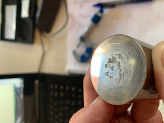

Hello all, I wonder if I might pick the brains of the knowledgeable folk of the forum ?
My car is a 1965 4.2 S1
I am adjusting the valve clearances (hopefully) to eliminate top-end noise (compression test and leak down test all good). On the exhaust side two of the tappets/tappet buckets are quite pitted. They are the centre two:
Tappet bucket.jpg (22.47 KiB) Viewed 14829 times
I haven't read about this issue anywhere else on the internet or having searched this forum.
Does anyone know what might cause this ? The cam lobes look fine although the clearances were around 7 though too large. Should I replace the buckets with new one (I assume so) ?
Also, following on from this, some of the exhaust clearances, which is the bank that the noise was coming from, were way out and in one case I need a 122 thou shim to replace the existing one. Does anyone know where I might source such oversized shims?
Finally, I am in North-West Hertfordshire, roughly between Hemel Hempstead and Ayesbury. One of the aluminium cam covers has a small crack in it. Would anyone have any advice as to where I might be able to get this welded ?
I hope that I have posted this in the appropriate manner but if not then please let me know.
Thanks in advance to anyone who can offer advice,
Richard.
paulsco
Posts: 825
Location: Oxfordshire
#2 Re: Pitted tappets
Post by paulsco » Thu Aug 20, 2020 7:17 pm
Hi Richard,
Chrisfell has mentioned pitted tappets in another thread, which may be of interest.
viewtopic.php?f=5&t=16314

Post by rblumsom » Thu Aug 20, 2020 9:15 pm
Thanks Paul, I missed that post which is very useful.
Time to research checking out the oil feed, but my suspicion is that the cam followers might have been reused after an engine rebuild some years ago.
Richard.

Hi Richard i would re check your measurements.....as to why you need the extra large shim....check out the thickness of the cam followers...also look at the top of the valves. ...have they been ground down at some time....also look at long skirt cam followers.....as cam followers wear they become barrel shaped and rock in the bore causing noise (you can measure to see if they are barrel shape)......the longer ones are less likely to rock...but before anything check the oil feed is ok.....what do the cam bearings look like....also see similar topic listed below.....Steve

Curious. Not the tappet wear, which is due to the breakdown of lubrication, the cause of which needs to be identified and rectified. No, curious that you have experienced increasing valve gaps.
If all is well, the only adjustment should be to correct reducing valve gaps as the valve slowly recedes in its seat. The cam heel cannot wear, the tappet only ever wears if there is poor oil delivery, the shims and valve stems cannot wear, although I have seen substandard, non hardened shims develop annular indentations from the valve stem.
I'd check those shims very closely.

Iv also seen plenty of shims with a well worn indent from the valve stem....Steve

Thank you all for your observations and advice which are much appreciated.
The history of the engine is that it was rebuilt around 15 years ago, when I had neither the time nor inclination to do such things myself by a local mechanic who I am still in contact with and use for other vehicles.
I have just spoken to him and he recalls that the head was re-built with new valve seats (unleaded) and valves. He thinks it extremely unlikely that the valve stems were ground down so perhaps the seats were not ground enough. Since then I estimate that the car has covered perhaps 15K miles. After this rebuild I noticed that the engine was "tappety" but as it performed really well have not addressed this until now.
The compression test, with a recently run engine, showed 160 psi across all cylinders to within 2-3 psi either way so I took this as a good sign.
The leak down test had similarly consistent and positive results with a little air heard to be escaping past the rings (the engine had cooled a little by then) but a stable and strong reading with no discernible leak past either bank of valves which suggested to me that they were seating properly.
I am certainly not beyond making a mistake with measurements but have checked and re-checked and also had a friend confirm the readings so I'm reasonably confident of the measurements (we even checked the feeler gauges with a micrometer).
The bases of the cam followers measure 223-224 thou on the inlet bank, with the exhaust bank the same except for the two pitted cam followers which are 221-222 thou. The cam followers are, I believe, the long skirt type (1 inch from top to bottom).
When I removed the cam covers they were "full" of oil, i.e. oil was sitting in the outside parts of the cylinder head below the drain holes to just above the lower edge of the cam cover, spilling out when I removed the cam covers.
So I think that the next steps (as suggested) are to examine the top of the valve stems for evidence of grinding; check for barreling of the cam followers; check the oil pressure independently of the dash gauge (which shows pressure off the scale but I understand that the pressure senders are notoriously unreliable); check the oil feed pipe to the camshafts. Any additions/corrections to this plan will be gratefully received, particularly re: potential oil feed issues.
After this, if nothing obvious, then perhaps replace the pitted cam followers, obtain over-sized shims (Rob Beere ??) put it all back together and check again after 1,000 miles.
Again, thanks to all,
Richard.
