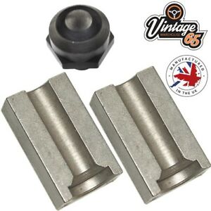

You don’t need to heat it, the pipe can be held in a pair of pipe flaring collets as per pic, if you don’t have any you can make by drilling a 3/8” hole between two steel or ally plates held together in a vice so you end up with something as per pic. Works beautifully, hold in vice with about an inchbpoking out, a couple of taps with a soft mallet and job done. Did a full car set in under an hour for the princely sum of £8.

Is it just me but that explanation has not really helped
Could you possibly explain a little more please?
#13 Re: Nylon fuel pipe
Hi Robbie...makes sense to me......your just useing the collets as shown or something similar to wrap around the pipe and be able to grip it in a vice without crushing it.....Steve

Maybe it was a little vague. The main problem on assembling the pipes is actually holding the pipe tightly without crushing it, so the banjo can be inserted. The split clamp/collet will hold the end of the pipe nice and tight without any damage/distortion allowing the banjo to be tapped in, it certainly doesn’t need any heat and works very well dry.
It’s also worth fitting one end only and trial fitting to car first and marking the correct orientation of the second fitting (if they’re both banjos) as unlike rubber, the nylon doesn’t take too kindly to being twisted when trying to line up the second end. Sits much nicer too. Hope this helps. Chris.
