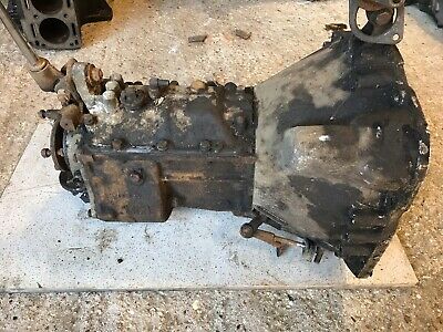

Another picture

NO Overdrive box will fit in a Short Wheel base E type . I have a suspicion that Julian has an OD box from which the OD has been removed i.e. the gearbox has been changed back to a non OD design
In relation to the photo shown at 41 I am mystified as to what the apparatus to the left of the OD is ??

I would think the huge canister type piece sticking out the side would cause problems fitting it into a 2+2....but if your prepared to start cutting metal its up to you.....but why would you want a 3 syncro.....Steve

Okay so this box is no good
What about a manual box from an early XJ6
Rob
Posts: 9088
#45 Re: What is this car
Post by mgcjag » Sun Feb 28, 2021 4:31 pm
Hi Rob.....if i were you i would put up a new post in the technical section. .......Gearbox optinons for a FHC........you should get some answers...im not sure on the xj6 box becaus i dont know what tail section it has.....most are o/d boxes and as said not a straight fit plus you would need a different top gearbox cover to get the gear lever in the correct E type position....currently about £800 new.....Steve

Sorry Christopher....the OD is very much still there.....I have even cleaned the oil filter....at present it is non working but that is due to an issue with the solenoid which will be a bugger to remove....I even have an old service report indicating it has worked....my car is proof that it can be done....although I didn't do it...
As an addendum it is an all synchro jag box....
