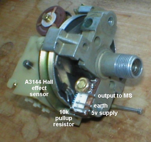

This acts as a speed sensor for the fuel injection system I built.
