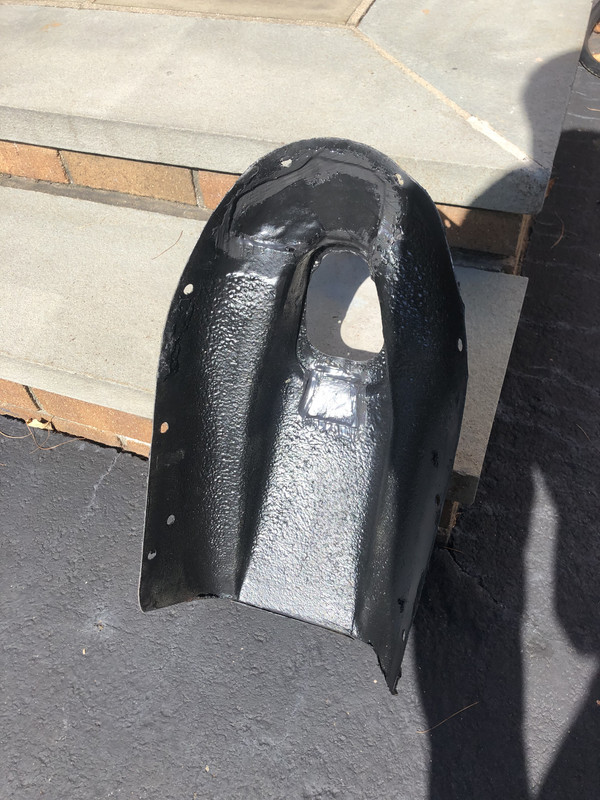

All sealed and ready to go
Black undercoating shows NO scapes or rubs
Any questions
Any questions
Next up is the xonsole

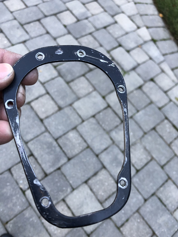

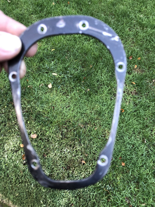

The RUBBER GATOR is getting chewed up on the sides from the metal hold down when shifting 1/2 or 5/reverse
So I will massage that black surround tomorrow.
Ordered both gator styles the round bubble and the one you see....Is the bubble bigger?

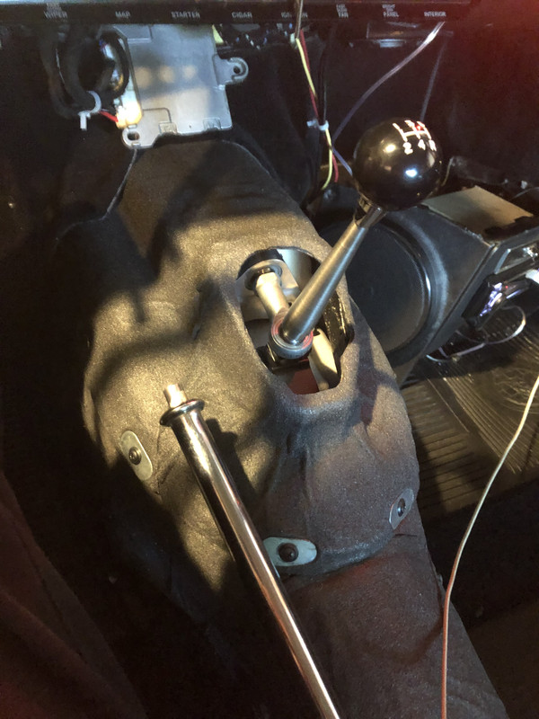

Is that an ECU positioned near the firewall ahead of the shifter?
#447 Re: The 5 Speed is here……..
ECU? I think its the radio.

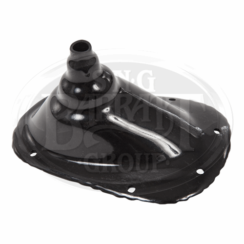

You could try the S3 gaitor which is silicone so unlikely to tear or chafe. I used it on my 3.8 Moss box to get a good seal on the opening. BD29420:
https://www.sngbarratt.com/English/#/UK ... a56863e45f

You were reading my mind, Ordered it 8 am
Thanks my friend.
More to come....
Im trying the bubble one as well

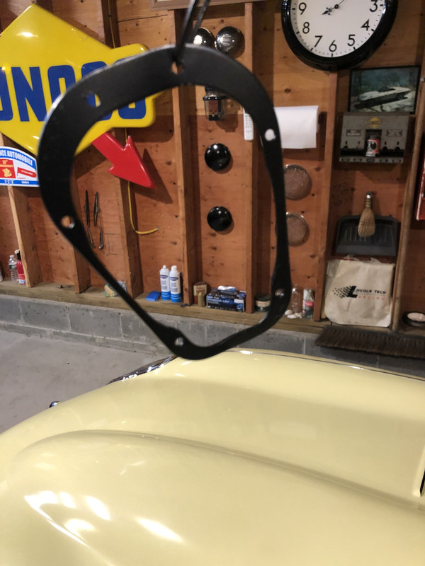

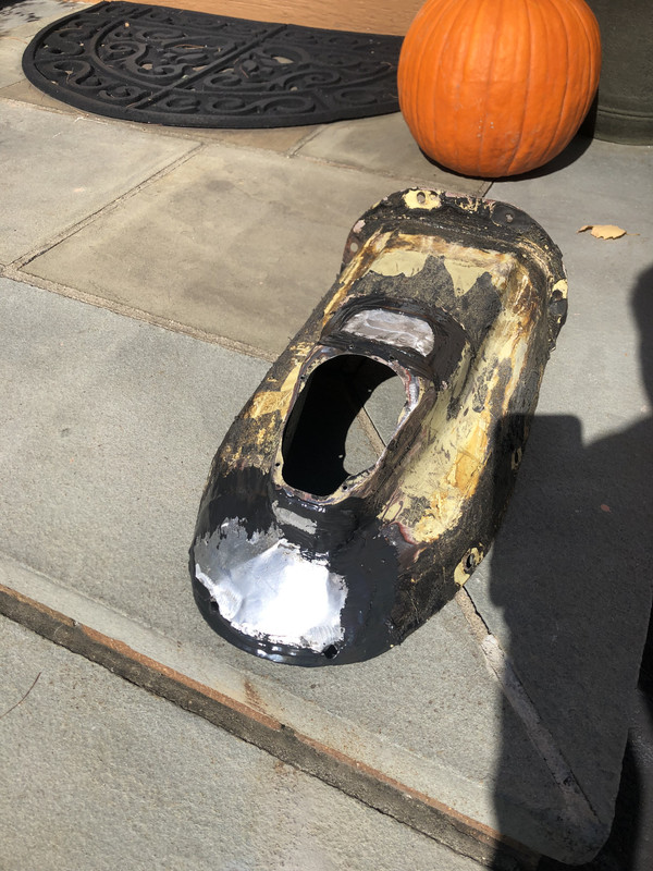

You have to massage the hood down ring.
Touch up with high heat paint and the Heuer rubber gator will be here tomorrow
All that is left is
Massage the original console or go custom?
The massage to the ring was for 5th and reverse.....clears by a mile now.
All that is left is

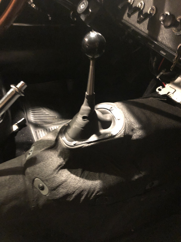

Tired will put the rubber gator on tomorrow then off to Jim Taylors auction and the D TYPE!
Hope the auction works out.
Once Im back,next week we start with the console.
That will be the last fly in the ointment
I need a break, but the car is driving wonderful!
