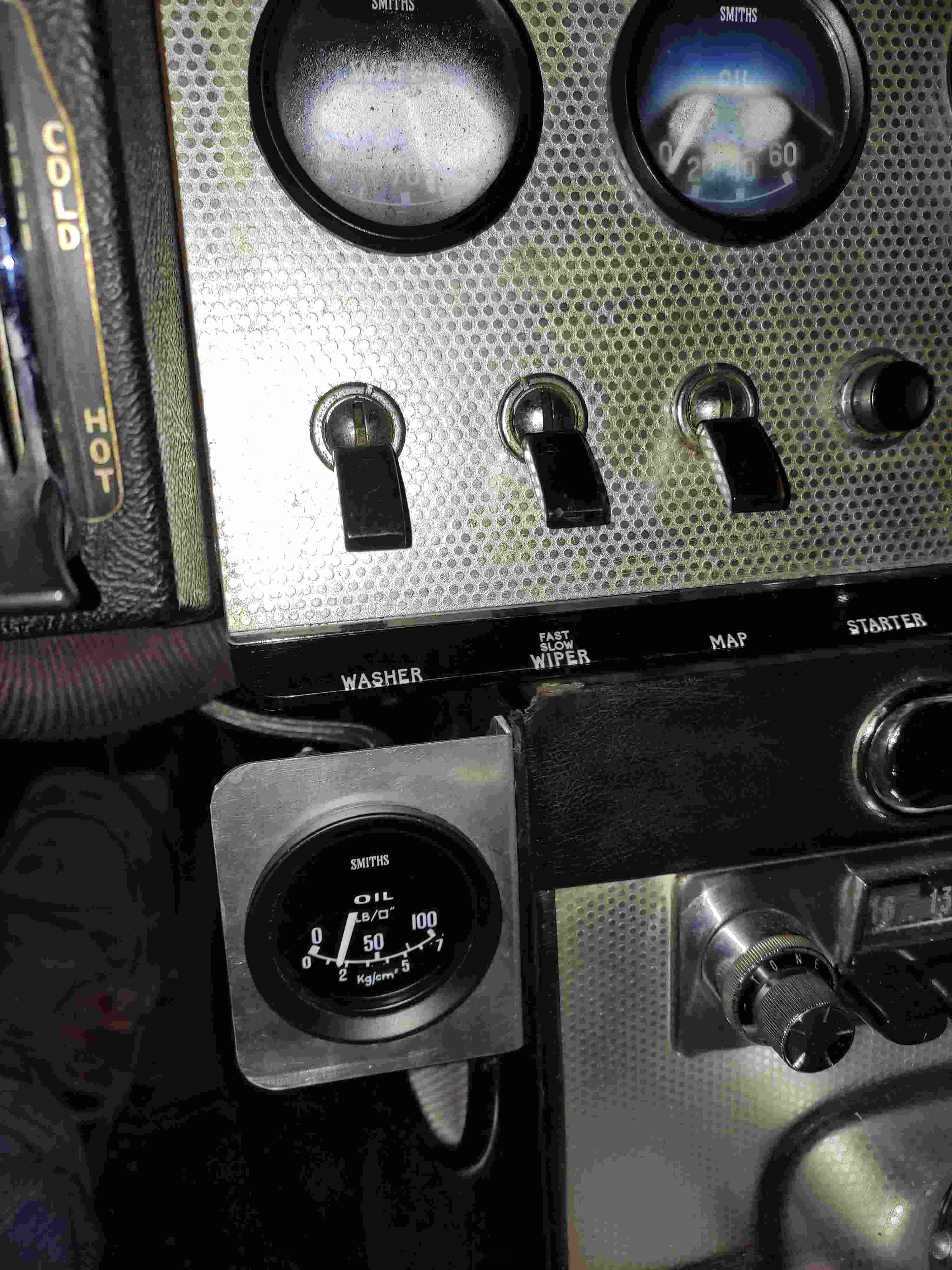

The gauges on my dashboard get misted when the engine warms up.
What is the right way to fix that: opening down the dash and heating the back of the gauges with a heat gun?
