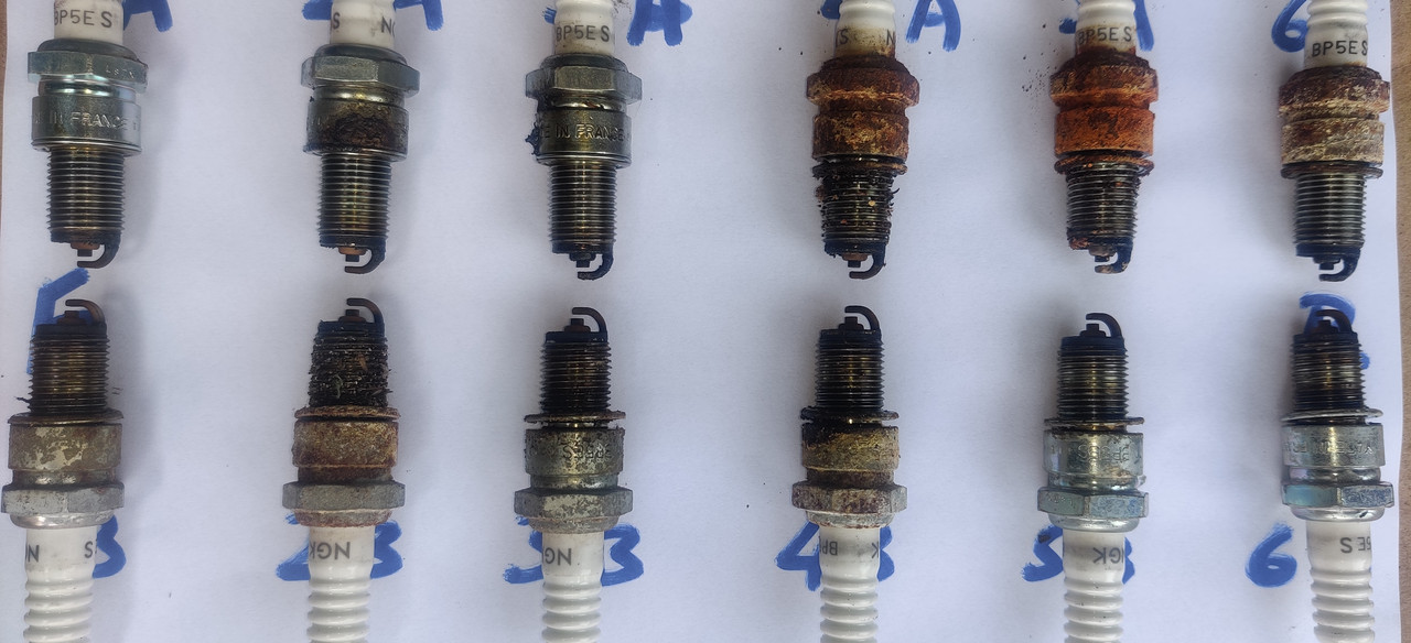

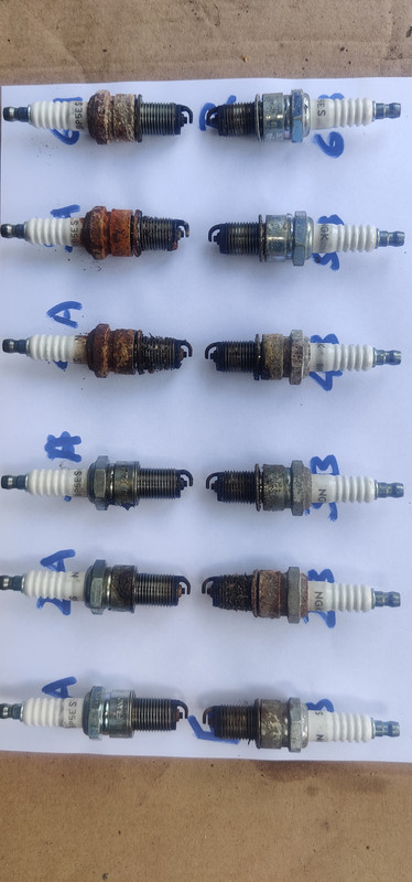

Erratum! Some of them look reasonable, some do not (if you can see through all the crap that's on the electrodes)....

Not wishing to state the obvious, but looks like there has been a coolant leak in that area!

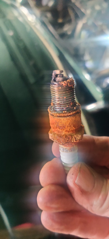

Or would you say water getting through bonnet vents and settling in spark plug cavities? The car has no rain covers installed on top of the engine. Nevertheless, would coolant produce this reddish residue? ATM certainly it is green antifreeze not orange.

by abowie » Tue Oct 03, 2023 4:28 am
Redman wrote: ↑Mon Oct 02, 2023 10:49 pm
It's rust from those plugs being in water in the divots in the head.

If it is coolant, I'd be surprised - engine gives no sign of head gasket issues (and I had a similar LR V8 that overheated multiple times and I had to replace the head gasket twice which included helicoiling the block to get some new studs in). But I must admit @71V12 it does not look like rust, more like chemical residue. Fingers crossed it is just water getting in and sitting there. Having replaced the plugs (and cleaned out each plug well to the best of my abilities) I'll pull them after a while and see what results. Finally, anyone any comments on the NGK BPR6ES (gapped at 0.6mm).

All of the orange stuff looks pretty external, so I'd also be relatively relaxed about that. If you are on choke for a long time, it implies some of the carburettors are too lean at low load. If the plugs are sooty and it isn't after a nice long run, then that may also be from your choke enrichment.

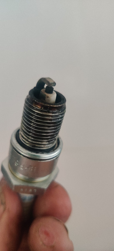

200 km later......on a good fast trip, plus took the advice of others on this forum and added some good quality 2 Stroke oil to the tank. Result is a clean clean plug (this one is 6B; I'll try 6A next time I check). Engine is running very well indeed. No comparison with what was going on before. Thanks all.
This was my first impression of the situation. That the rain shields were not in place. I removed mine several years ago, because it covers so much of the engine when I am at a car show. I don’t every wash off the motor for fear of getting standing water in the plug wells.
