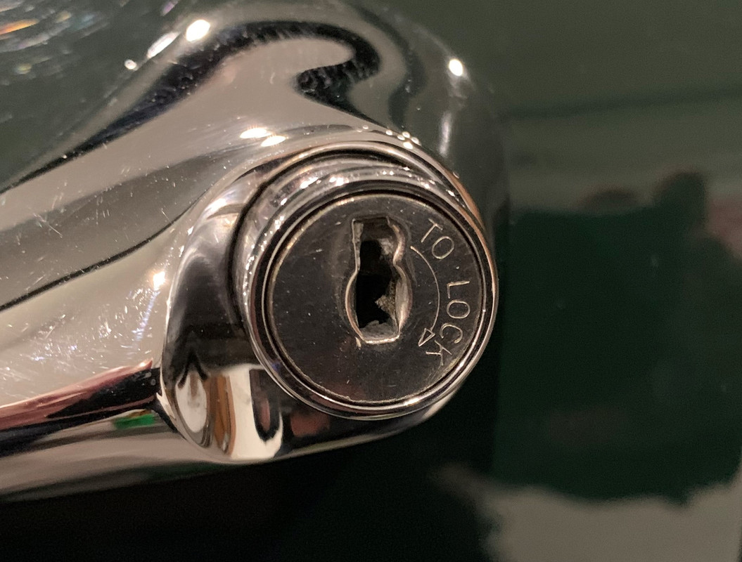

Door Lock Push Buttons
Original Door Lock buttons are marked with an arrow showing the direction the key should be turned to lock the door. From what I have seen over the years, reproduction lock buttons do not have the arrow present.

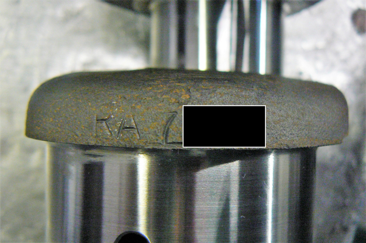

Engine Number - Other Locations
Sadly, these can only be seen once the engine is stripped down but, in addition to the head and the block, engine numbers are also present on the flywheel and crankshaft
