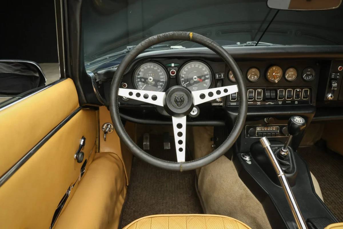

Just out of interest, where do you find the instrument dimmer switch on the dashboard?

If it's anything like mine was, the three positions are "Off, almost unnoticeable, dim"Craig Balzer wrote: ↑Tue Nov 04, 2025 9:16 pmThe switch is a simple 3-position one: off-dim-bright
Just left of the headlight switches:

I got to thinking about your question regarding a dimmer switch.
There is actually another dimmer on Series III's (may be also on earlier series, just not that familiar with them).
This photo from the 'net shows the US driver's footwell.
There is a stubby black knob down in there at shin level; just above the chromed bolt that holds the radio tower in place. It controls a rheostat for the dashboard gauges - I just don't remember which ones.

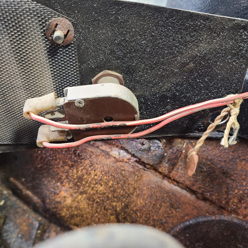

Here is the back-side of that knob:
