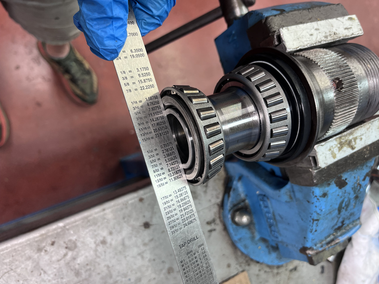

Yes, obvious now, the spacer determines how much crush the bearings feel - thinner spacer equals thrust face closer together, equals less room for the bearings, equals higher bearing load.

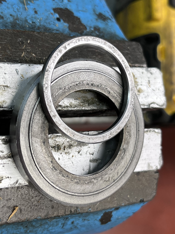

For some reason my inner thrust face is very neatly chewed up, so neatly that it could almost have been deliberate machining, only it was done by the fretting of the hardened spacer and the bearing track, because at some point in the past the nut wasn’t cracked down hard enough.
Edit - NOT true, bollocks even, see below.
You are right, Andrew, the rim movement corresponded to 0.15mm end float, which is not too far off spec - only my float was for the wrong reasons.

To save time will get it surface ground back to flat tomorrow, it only needs about 6 thou off it, and the thickness makes no difference to the shimming, of which I’ve got a full set anyway.

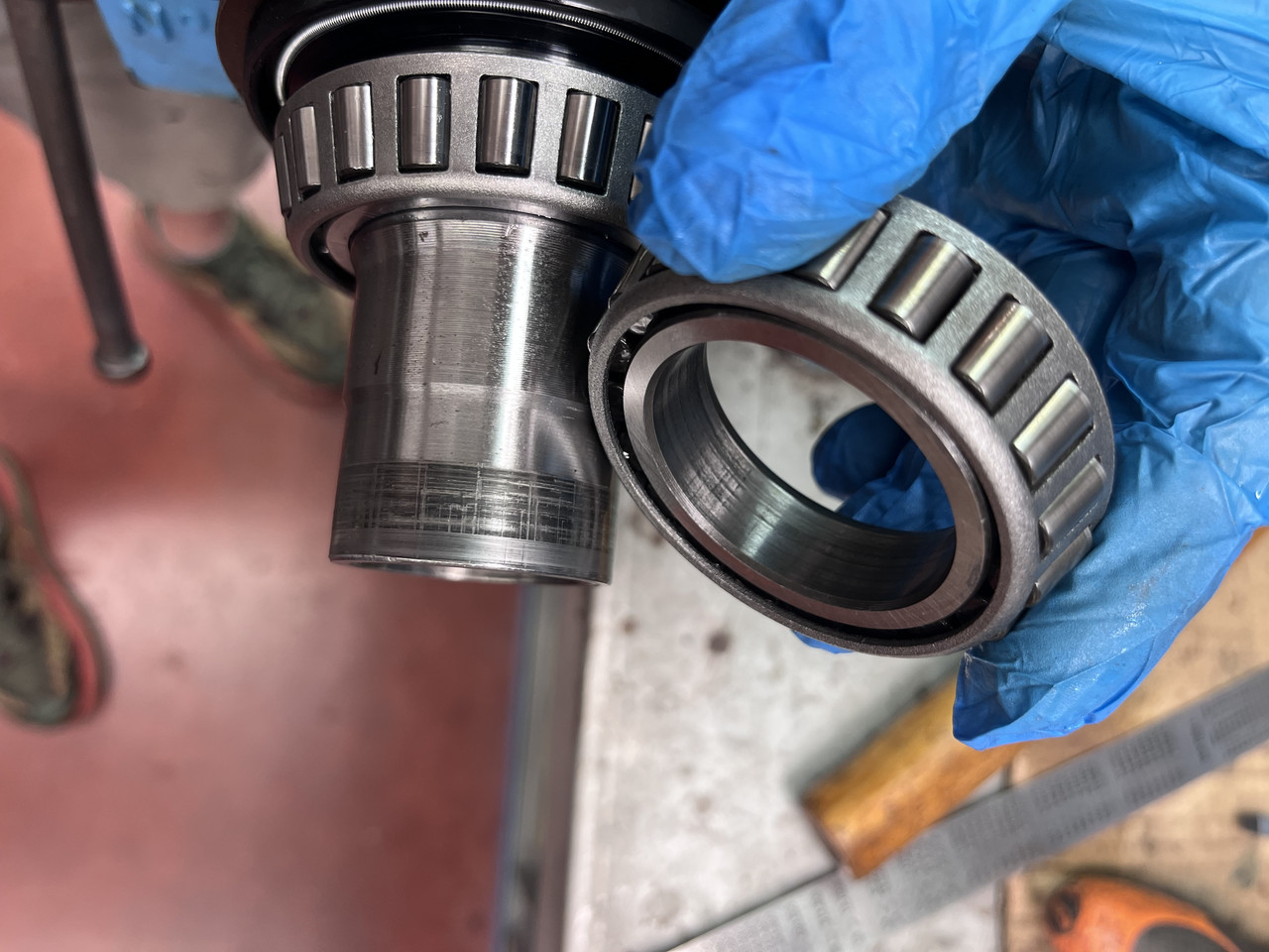

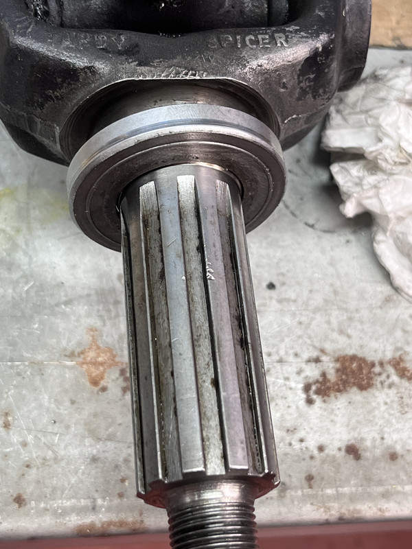

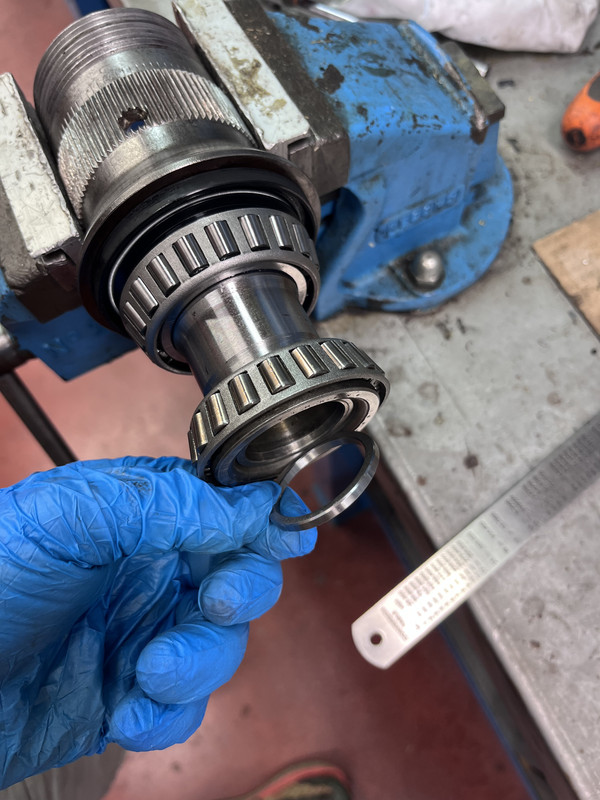

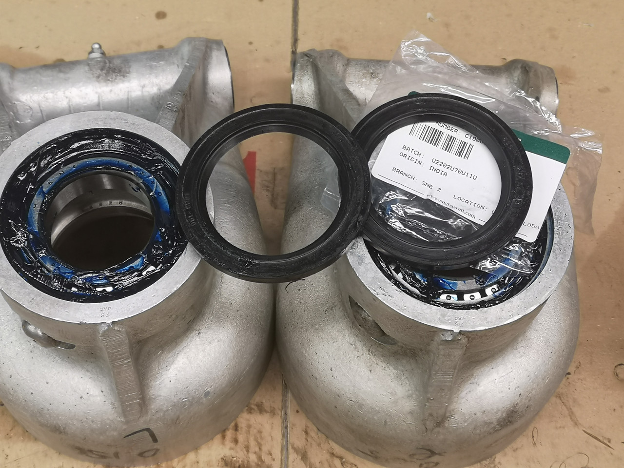

The key design aspect of this rear-hub set-up is that the inner race has to be an interference fit on the stub-axle, which is why it is meant to need a press - the effort is to shift the inner race off the axle.
The shim or spacer used ends up hard against the flat face of the collar that is also the oil-seal track,and that collar is trapped by the compression of the nut that clamps the drive-shaft inside the stub-axle.
That same face is also meant to be hard against the back of the bearing, see below.

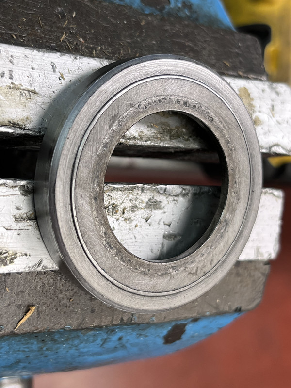

And no, the collar's face is NOT meant to look like that.
My hub comes apart almost without a press, because the bearing has fretted - through insufficient interference - on the axle.
Therefore the inner race can potentially turn on the axle, like this :
- and in so doing it rubs against the flat-faced collar, which it is not meant to do.
Hence a collar that ends up looking like this - albeit easy to change, or in my case probably surface grind as SNGB haven't got one and I need the car ..........
Has anyone else had this issue with insufficient interference at the bearing/axle interface, and did they manage to make it all work by using bearing-fit Loctite - obviously only upon final assembly, once the thickness of the necessary spacer has been established ?
Posts: 9208
#16 Re: Tolerance for rear wheel bearing..
Post by mgcjag » Wed Sep 23, 2026 9:07 pm
New hub and bearings for a proper job....but if you need a quick fix you could use a center punch around the worn hub area creating a surface that would need a press to push the bearing back on..and loctite for belt and braces....the punch method was often used on the front hubs to provide a tighter fit to stop bearings slipping/spinning/wearing the stub axel....Steve
Posts: 4151
#17 Re: Tolerance for rear wheel bearing..
Post by abowie » Wed Sep 23, 2026 11:17 pm
Rory I used a Loctite product on a rear wheel bearing in my Mk2. It is supposed to cope with up to 0.2mm 8 thou spaces.
