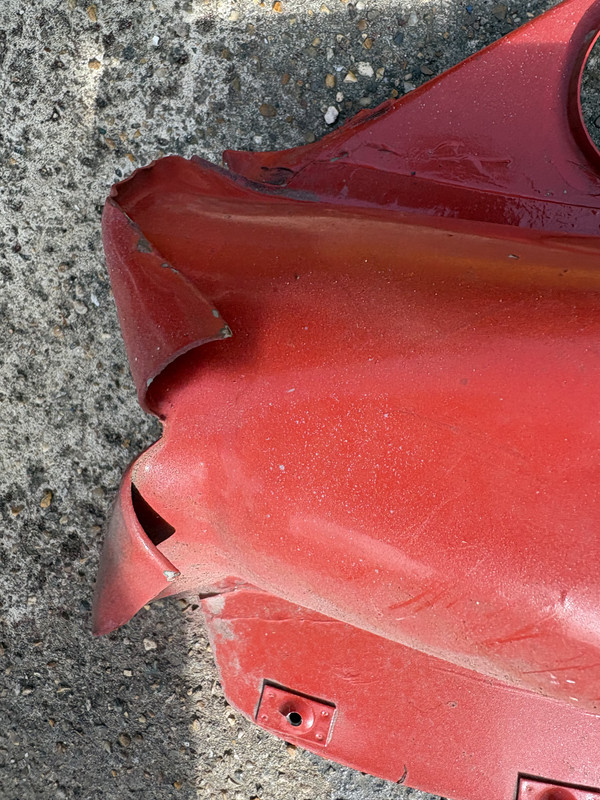

The captive nuts at the bottom show its original in my thinking, I have not been able to find a source of those captive nut plates though that doesn't mean they don't exist somewhere.
But in addition the spot welding that fixes them in place appears to have been made with a 4 electrode spot welder as they are consistently spaced which is not something you could easily achieve, also the size of the spot welds would make me think its original, or at least as original as mine.
Tony
