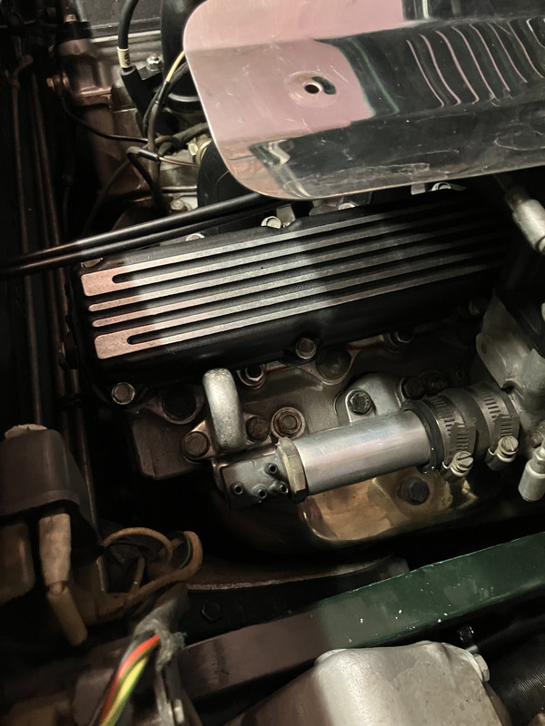

Could someone please let me what the pipe/cable with the white plastic wrapping around it and the back of the right side cam cover in the top photo does?
Reason I ask is that I’ve noticed it’s missing since I had some engine work done by a specialist on it recently and I’ve noticed it’s not there now.
It is a 1972 New Zealand spec car so I assume it’s the same as UK spec.
Many thanks,
Marcus

That is the thermostatic valve whose main purpose is emission control.
There are early and late versions and minor differences whether your car has a manual or auto transmission.
It is shown in the upper right corner of this page from SNG Barratt's
https://www.sngbarratt.com/English/us/F ... mbly/18158
As yours sits now, you have one or more vacuum leaks; the various ports are activated by engine temp and -- I think -- RPM.
I would ensure your "specialist" replaces the vacuum lines as original.

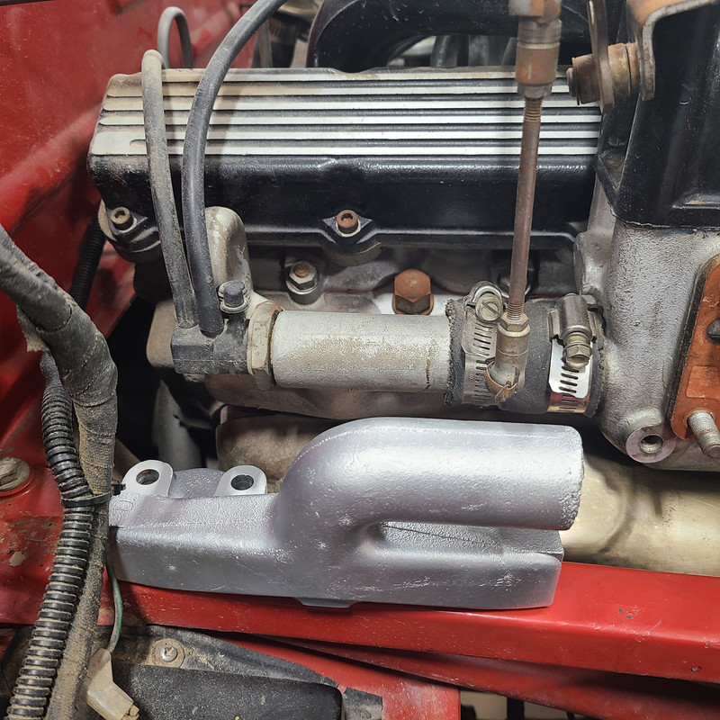

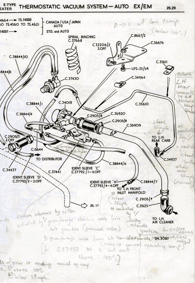

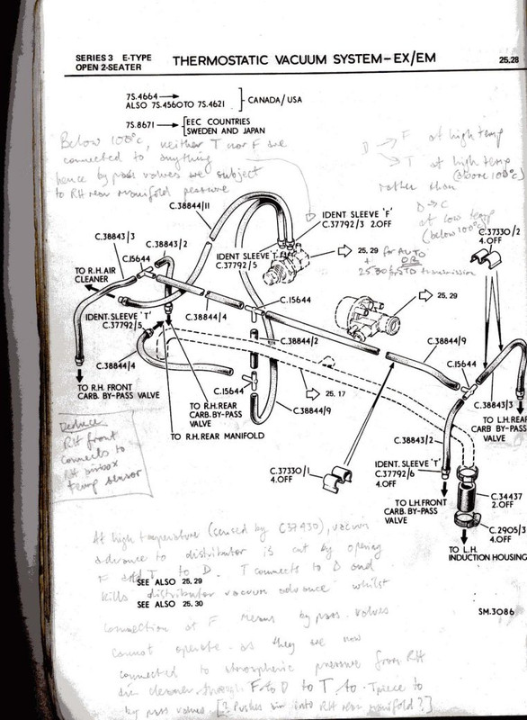

These may help
I replaced mine with a housing from a 1971 V12
