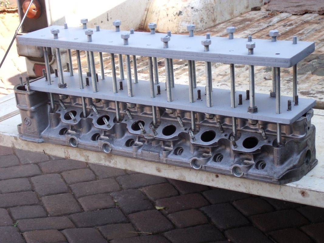

Meet "Godzilla": my own V12 head removal tool:

#14 Re: V12 cylinder head removal
Instructions for use:
1) Use cam bearing studs to fasten thinner, lower plate to the head;
2) turn threaded rods without the hexagonal heads down towards head until they all rest on the main head studs;
3) Now turn the bolts with the hexagonal heads on top of the thick plate clockwise typically 1 turn at a time making sure they are all turned equal amounts so as to ensure both plates remain parallel to each other.
This action pulls the bottom plate to be pulled towards the top one and causes the threaded rods in #2 to be pressing down on the head studs.
One benefit of this tool is that the rods pressing on the main head studs do not turn, they only press, thus limiting potential damage to the head stud threads.
