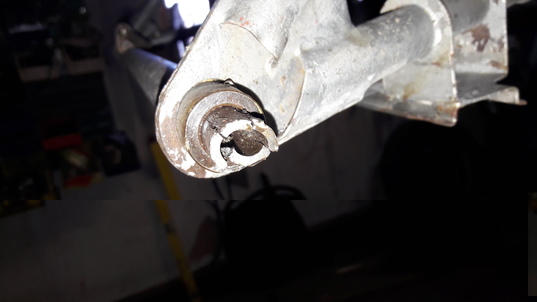

Post by politeperson » Sat Nov 26, 2016 6:02 pm
Well all sorted now.
I cut the top hat flange off and heated the collar up a bit.
i also tried the hot wax trick after I had wire brushed it.
Anyway, the fact is it doesn't matter how much you twist the collar with stilsons. The collar will self destruct and go oval first. Have a look.
Out it came.
I checked the fit of the new collar. It would not go inside the tube until I has cleaned it up nicely with the Dremel.
All good now, so I spent the next 5 hours refinishing the frames.
I feel I have removed 50 years of knocks and scratches. I also removed the annoying dents where the motor had scraped in previous removals.
Might get my engine in next week.
