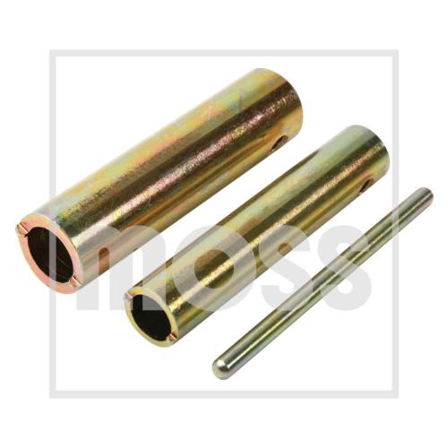

Make one for doing the toggle switches as well, it's WAY better than faffling about with snapring pliers. If you make one out of a bit of pipe then it will move the lozenge for you, if you make it out of a plate then it'll still be a bit fiddly.

#8 Re: Ignition switch loose
Post by neil4444 » Sun Jun 04, 2017 9:27 am
Lucas Bezel Tool.jpg (21.91 KiB) Viewed 7312 times

JagWaugh
Posts: 559
Switzerland
#9 Re: Ignition switch loose
Post by JagWaugh » Sun Jun 04, 2017 9:54 am
That's what I made, I had some 25mm and 19mm stainless pipe. I didn't bother with a tommy bar, that would have taken another 5 minutes to make - mine just have a bit of cloth tape on the end.
But for 20 pounds... not bad
